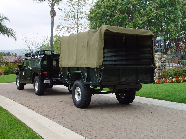

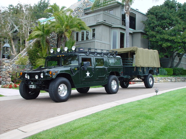

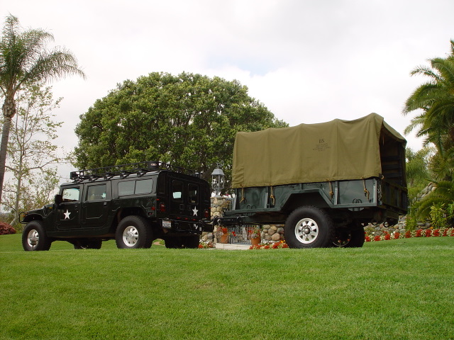

The boss went out and got himself a 2000 AMG H1 a while back, so I decided he needed a matching trailer for it as we like to ride dirt bikes and ATV's. Found a local M105A2 through Government Liquidations and we got right to work on it.
- We started by block sanding it down
- Removing a set of leaf springs (the heavy duty set)
- Removed the air brake system
- Painted it to match the Hummer
- Found a nice Beachwood Canvas to go with it
- Changed the wiring a little bit to work with 12V
- Rhino lined the inside of the bed
- and finished it off with a custom axle to mount matching Hummer wheels
What do you guys think?

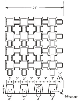

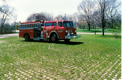

I'm jealous of the driveway and hate the manicured landscaping. My driveway now is RCA. It’s strong but not pretty. I'm saving up for those concrete steel reinforced waffle pavers. They are cool because you don't have to worry about drainage and it looks like a lawn from a distance. You also don't have to worry about staining it like a solid conc. Driveway or pebbles/gravel all over the place after the snow melts. It will take H-20 loads. Here's some pics.

No.2diesel - that is a neat paver/brick, what ever you want to call it. I would go that way too if I had to worry about snow. Thanks for the compliments
ARMYMAN30YearsPlus - All I did was flip the tongue, and vuala, perfect fit. Of course, getting rid of the HD leaf springs helped lower it a good ammount too. Thanks for the welcome.
Elwenil - The top flaps around a bit when being towed. I found that by removing the end curtains it doesn't do it as bad. Plus, it's not like we have anything to hide. Funny you bring up an M35. I got the idea for the stars from one. Might even be the same one you speak of.
Maddoawg308 - The civilian H1 shares just about everything with the HMMWV. So it has an automatic and a 12v system, BIG DEAL! Same truck with a few creature comforts. And just because its shinny, it doesn't mean we don't use it for what it's meant to do. You should see the paint up close.
