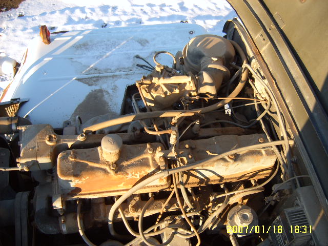

Any advice on where to start on reviving a dead M246?

Start with trying to crank by hand. Once sure its not locked up, I'd put some marvel in the cyinders and let t soak for a spell. After that maybe hook up some batts and try cranking it by the starter. Don't forget to check your aircleaner and plumbing right to the carb. You find mud dobber and wasps nests everywhere. Make sure you have a functional mechanical oil pressure gauge before you start.

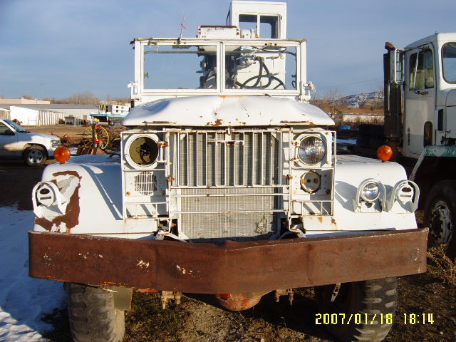

Unless there's a hole in the pan, block, etc., I would just about bet money, that this old girl will probably fire up. I've woke up more than several and it usually don't take much to make them go. I can't remember if anyone pointed this out, but the 2nd stage of the crane is extended manually, unfortunately not with the hydraulics. But, don't let that talk you out of it.
What is that sitting beside it in the pic ? Looks like some sort of civilian 6x6 ? ?

I read the manual on the truck, can't recall off of the top of my head, but it didn't look too bad on extending the 2nd stage.
The other truck beside it is an old International dump I think, I didn't pay that much attention to it cause its in bad shape. The old guy is a pack rat and has ALOT of vehicle stuff around there, but this is the only military vehicle that I have seen so far.
