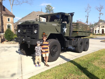

I'm looking at an '86 M931A1 on FB that the seller is calling a "M921A1 former tractor rig"
W/42k miles for $11k.
it's been frankensteined a bit but given the low price motivation and close location, maybe I could enter 6x6 world.
But With the older Nhc250, is this a waste of time or workable machine? It would be a parade queen but certainly OHV mud smashing too. I'd have to acquire a real 900 series cargo bed or fab something. Any advice is golden🙏..

Did he extend the frame too? That’s longer than a 931.
Yes his description says
"1986 M921 originally a tractor rig
NH250 Non-turbo
Allison 5 speed transmission
Professional frame extension and trailer bed added. Bed is set up with two aluminum benches for passenger seating.
All brake diaphragms professionally replaced. Starts, drives and stops amazing.
7- Goodyear 14X20 tires
8- Hemet wheels
All fluids changed when purchased. Both rv 5th wheel hitch and trailer receiver mounted in rear. Will need: front axle boots, fuel gauge works intermittently, windshield wiper valve replacement

Those aren't HEMTT rims.
14.00s are getting scarce. I'd choose 16.00s or 395's, and those look like 395s.
Changing brake diaphragms is pretty trivial.
The boots are no big deal.
That's an M105 bed.
I like truck tractors with a 12' bed and truck tractor length frame. They look proportional like that. This one looks awkward.

What are your plans for the truck?
If you just want to drive it as is, it looks like you're good to go with the minor fixes described above.
Otherwise, you've bought in to a lot of work to get the truck back to a semblance of originality. In the haze of infatuation and apparent cheap price, that work almost always takes much more time and money than what you're thinking.
That's an M105 bed.
The front rim is definitely a FMTV/LMTV and I also think they are 395's on the front.
Pic angle makes it look like the rear could be 14's. Doesn't look the same height.
Probably someone not informed fully but not trying to deceive. YMMV
Truck is cool and definitely worth considering. I would consider finding a bed to replace the M105 trailer bed.
The rear add on frame is growing on me and could be a platform on the rear of a new bed. I also like the steps in it.
My .012 is go for it if it drives well with no leaks or issues on a test drive.

I was thinking that. Seems like I'll be doing a month of steel work to bring the rest back up to looking good.

Here's other pics of the wheels. Seems like tire musical chairs
