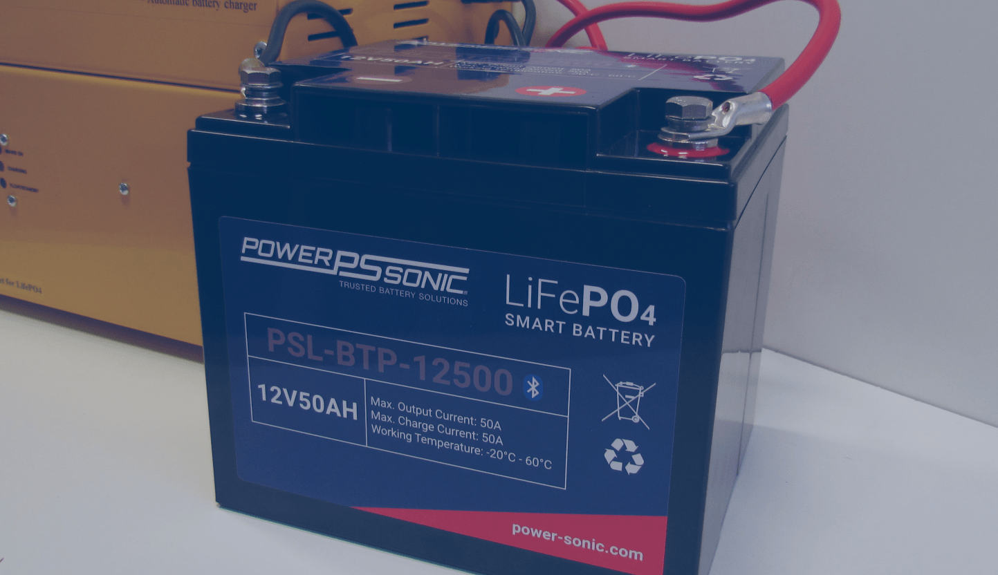

OK, so the stock batteries are AGM 12v 20ah.
Mine have always gone flat in a short period if the unit is not plugged in (so I know there is a draw). I've gone thru two sets of batteries to date and I'm not going to keep feeding this thing $150 worth of AGM batteries a couple times a year. Once they go flat, they of course never hold a full charge again and degrade with each hard drain. And leaving the cooler running 24/7/365 is not an option for me.
What I'd like to do is replace the AGMs with Lithiums (actually I can get 12v 20ah LifePO4 lithium battery for the same price I pay locally for the AGM).
Lithiums can be taken flat w/o harm to the batteries. I even have already added charging ports for each battery so I can charge them when the unit is unplugged. But if left unplugged (ie no charger) even a few days, the batteries are sucked flat.
My concern is the internal charger. What will it do when plugged int 110v and it starts to do it's thing with Lithiums onboard opposed to AGMs? I know that most chargers these days have a setting (or auto adjust) for the various type of cells.
*I only ever plug the unit into 110v to "pre-cool" it and load my food, beer...then I roll it out to the crane and lift it onto the trailer
If this article is correct, I should be able to do this (ie: you can charge Lithiums with a SLA charger):
*again, I only plug it in to "pre-cool" it (I have an external charger)
I wonder if there is a way to disable the internal charger
*and use my external ports for my Lithuim--capable charger.
*basically what I was already doing opposed to leaving the unit running 24/7/365
Or is that even necessary (ie: the internal AGM charger will work fine with Lithiums)?
Maybe I need to introduce a disconnect switch for each battery for when the unit is plugged into 110v
But I'd sure like to upgrade to Lithium if possible.
tldr:
  1. I want to use Lithium batteries opposed to replacing AGMs every season
  2. I already have external charging ports installed for each battery
  3. I don't want to keep the unit plugged in and running 24/7/365 (but I can leave a pulse charger attached as needed)
Thoughts?

I have lithium batteries in mine without issue. It is a pain having to take off the lid and disconnect the battery connector every time I'm done using it.
