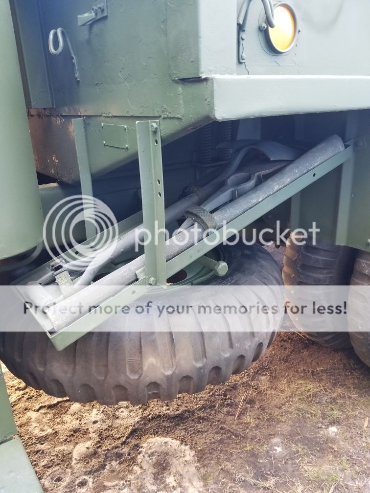

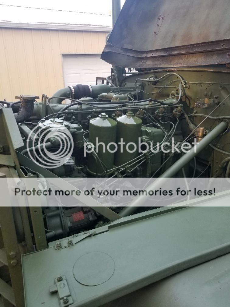

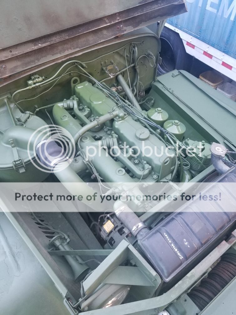

My first truck was a 1964 M35A2 with the multi-fuel engine/turbo set up. I got my truck from a wholesale dealer out of NC so I was able to go look at it & do a test drive as well too. I paid $5000 for it & another $600 to have it transported to me, but to date I've dumped well over $8000 in her lol. Now this has taken me 4 years to get her to this point & at any point she was drivable. I just wanted to completely go through the truck & bring her back to her former glory to parades & truck shows. If I did it all over again I'd go the same route, my truck came with a hardtop & a front winch however I had to add a heater unit & the air-assisted transfer case. Here she is...
