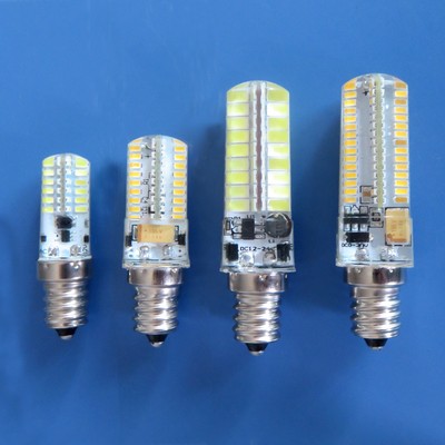

Would these be proper green LED replacements for the 3 half moon lights:
Main concern is that they may be too tall?
Thanks
pclausen
452
281
Afton, VA
Ah thanks. Wasn't even looking at the voltage. Well, in that case, it looks like the slow boat from China white ones from the auction site is the best bet as others have pointed out already:
