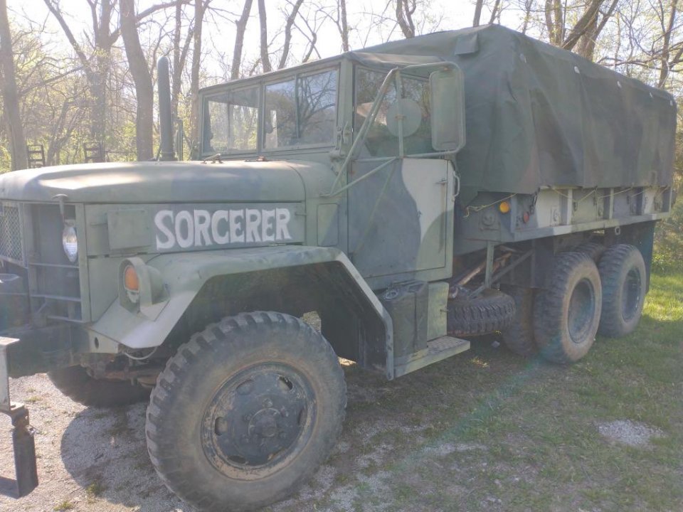

Hello,
First I want to say this is an awesome site and great community. I've been lurking here for a while and the advice and information about M35's has been incredible. I figured I would finally make an account and join the ranks.

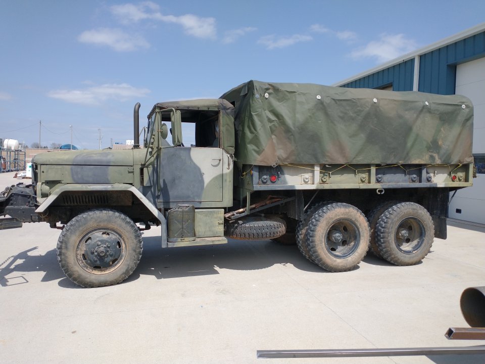

I picked up this 1970's M35A2 in running condition. I've been doing some small repairs, fluid changes, and PMs as I learn more about it. It seems to have a case of "making it's own oil" that I'll need to address soon. I have a dozen automotive projects at any given time, but this is my first MV and it's been completely different! Very enjoyable so far.
-Wolf

Welcome to Steel Soldiers! And congrats on your truck. Post a few more photos, when you have a chance. If you've been lurking, I'm sure you know. But if you get stuck, don't hesitate to ask for help. Enjoy!

Welcome from N.E. Ohio! Awesome looking truck. The "making" of oil sounds like a leaking fuel density compensator. It's easy to bypass, and there is a lot of help for that on this site.

Thanks for the tip. The FDC was already bypassed by the looks of it. It had the "looped fuel lines" strategy. I was going to do the fuel shut-off O-ring next simply because I think it's the easiest. And then the booster pump, and then finally the hydraulic head which sounds to be the most difficult.
So far I'm just keeping an eye on oil level after the initial oil change to see how rapid the leak is.

This is a good looking truck! W/W as well!
If you enjoy driving it, I suggest going for taller tires. 11.00R20 allow you to run duals if you want. You may already have looked at the suggested upgrades that make living with the truck easier and safer. Remote brake reservoir, front manual hubs etc.
Thanks! Do 11.00 R20 tires clear the front when steering without issue? I did just install the remote brake reservoir. I couldn't believe how difficult they made it to check the brake fluid.
I also just did the 3535XL muffler addition several others here have done. I plan to drive this truck quite a bit.

No clearance problems with 11.00R20. They are narrower than the super singles so many folks put on.
