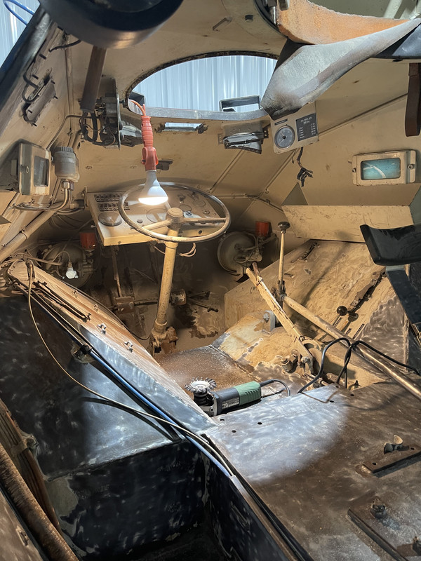

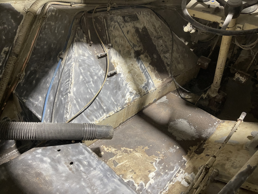

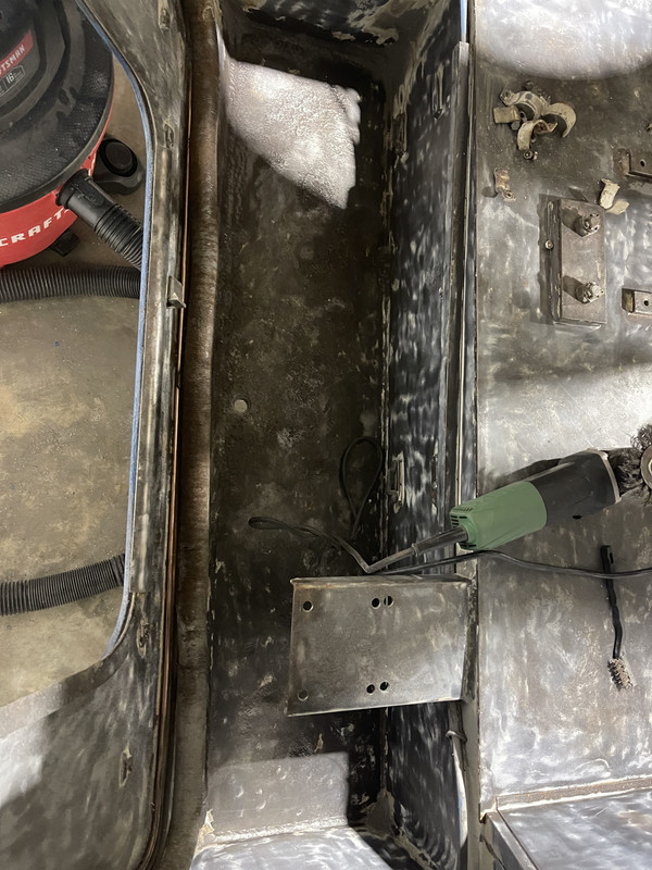

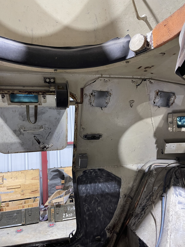

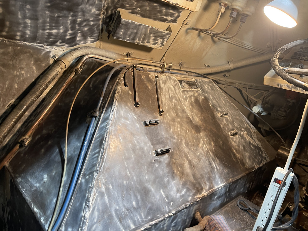

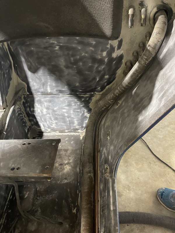

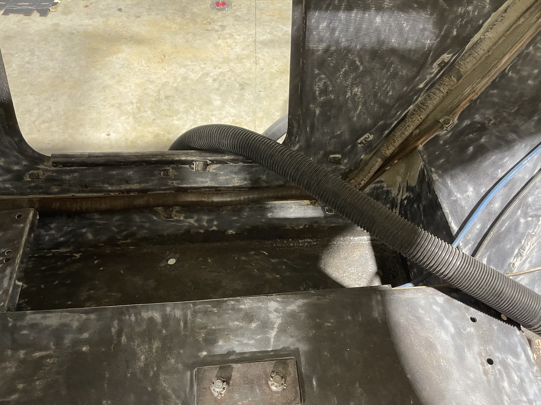

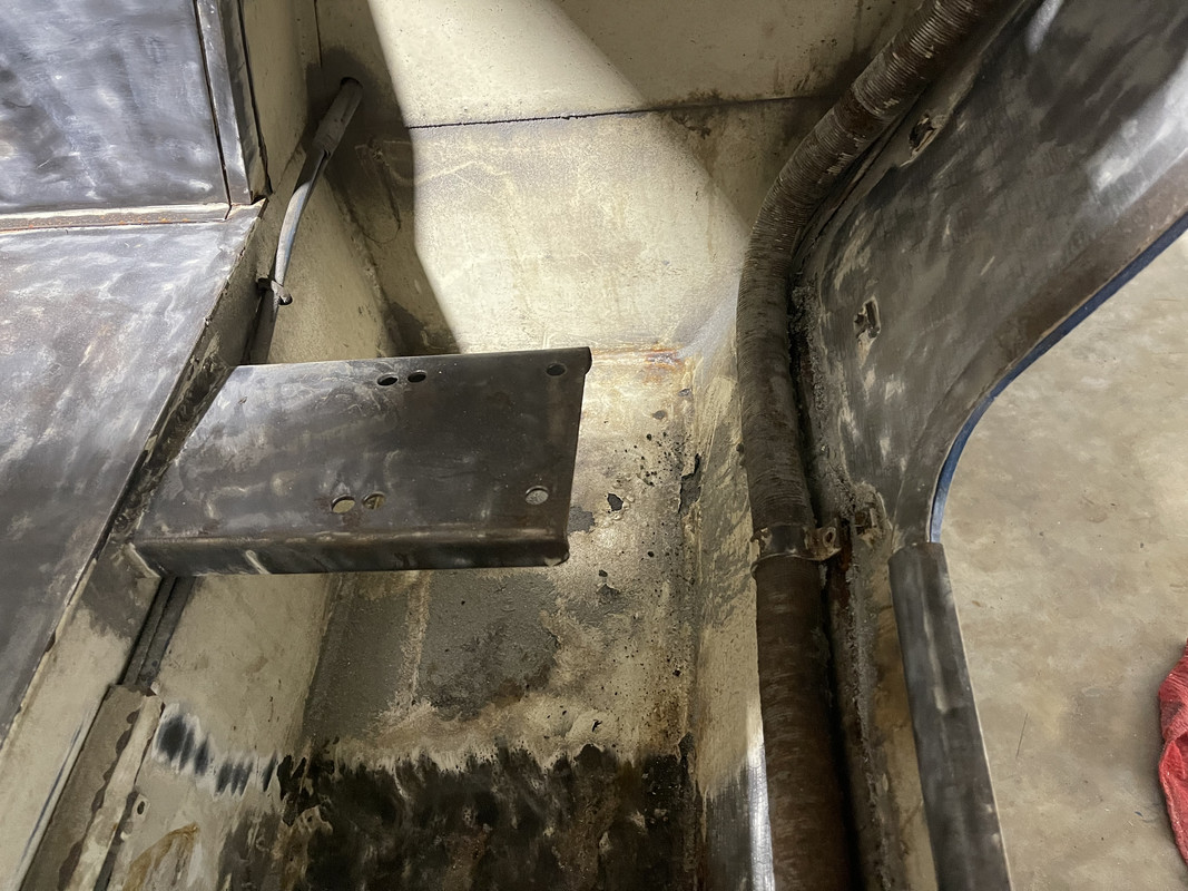

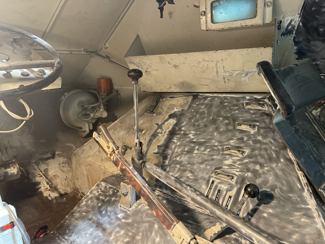

Progress update. I’m in the last 20% of the interior.
Ive been using a LOT of harbor fright tools lately, especially the Icon series tools. Unfortunately their weird sizing meant the 1/2 impact socket set didn’t have the 30mm socket I needed so I busted out ye olde Tekton which had it. Same kit ive had for years and has never let me down.

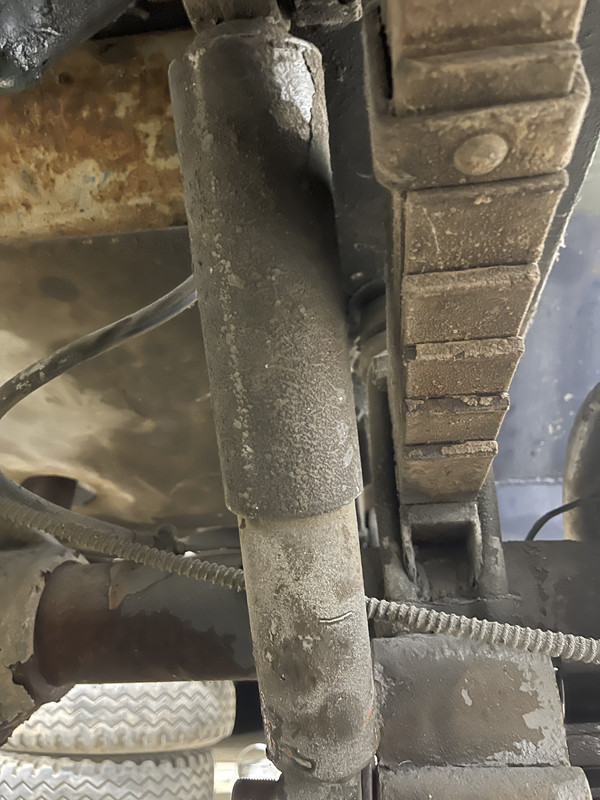

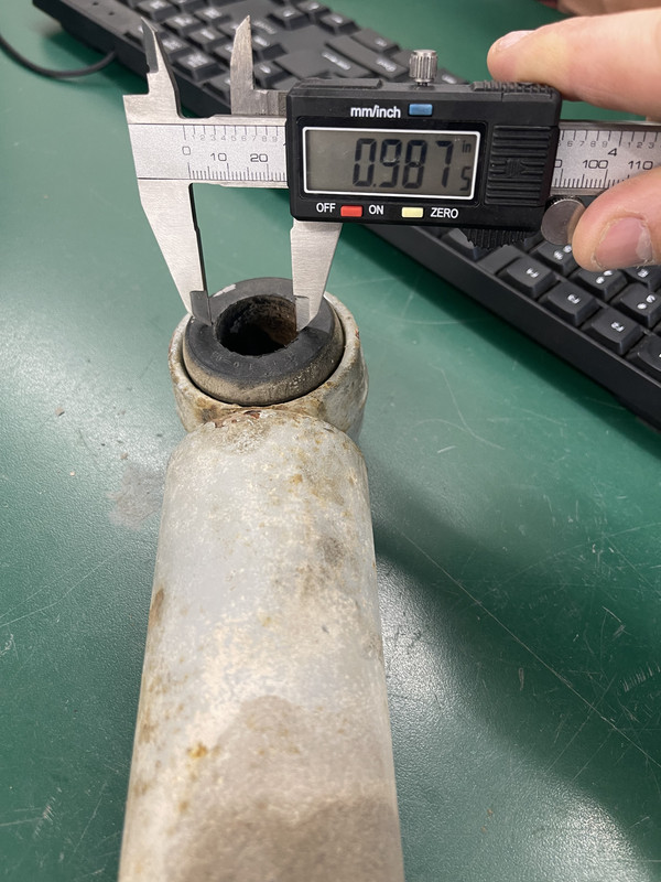

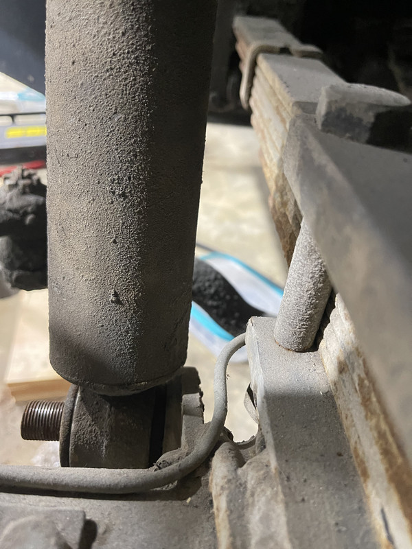

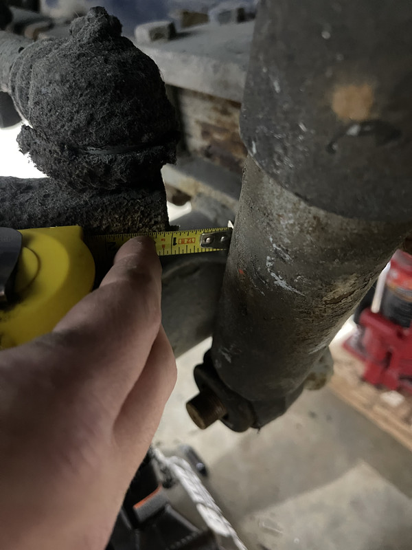

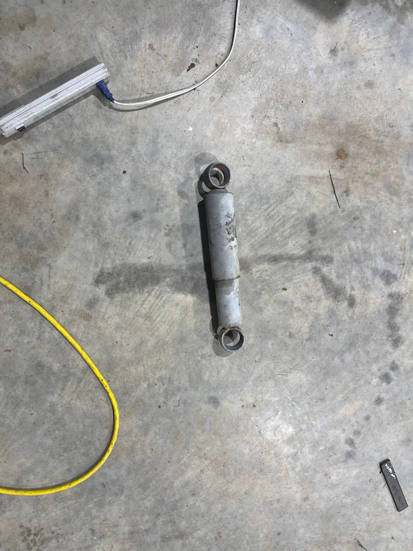

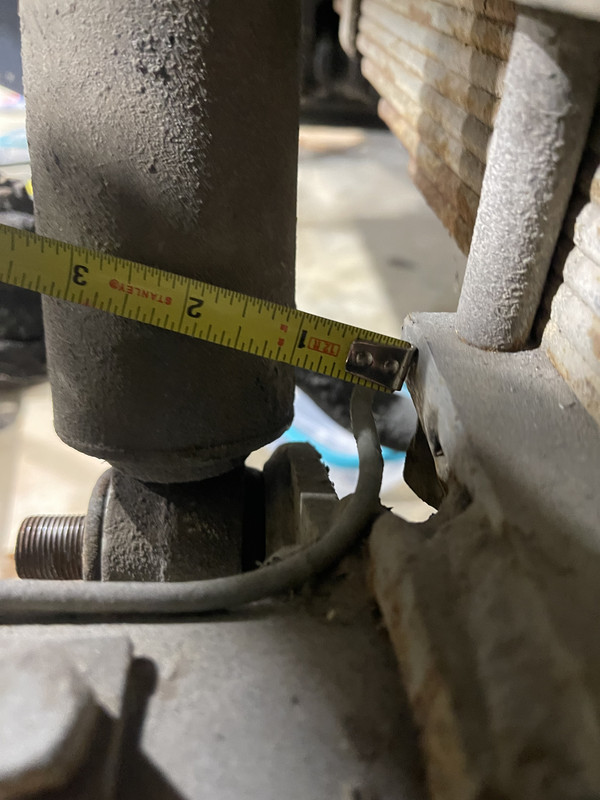

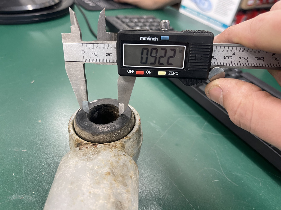

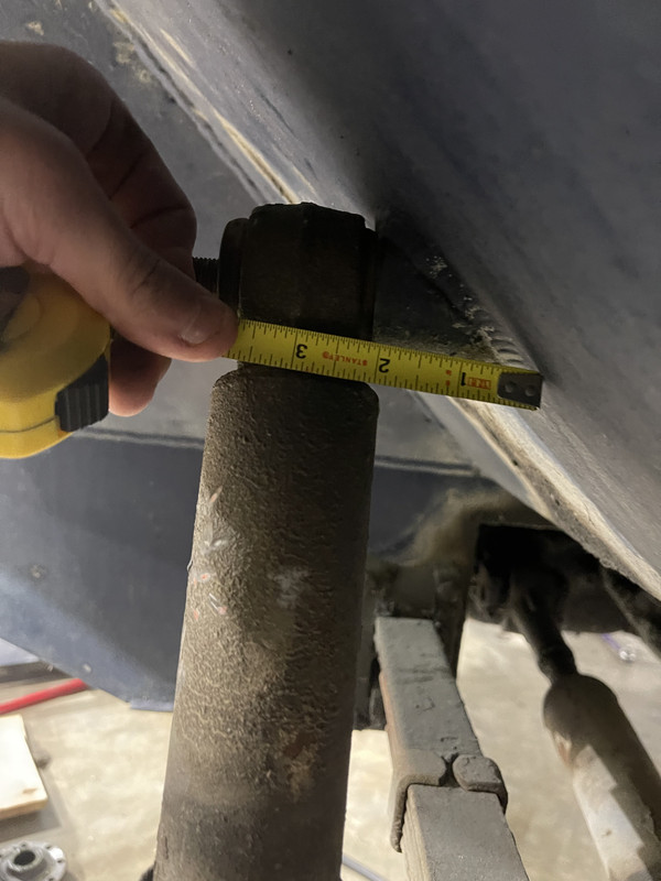

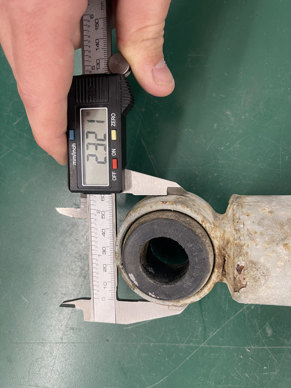

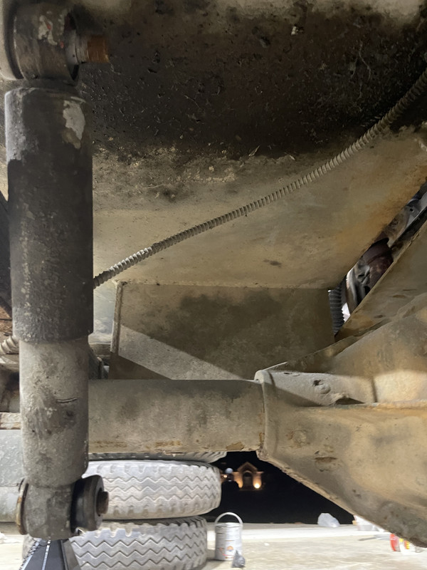

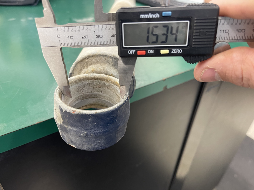

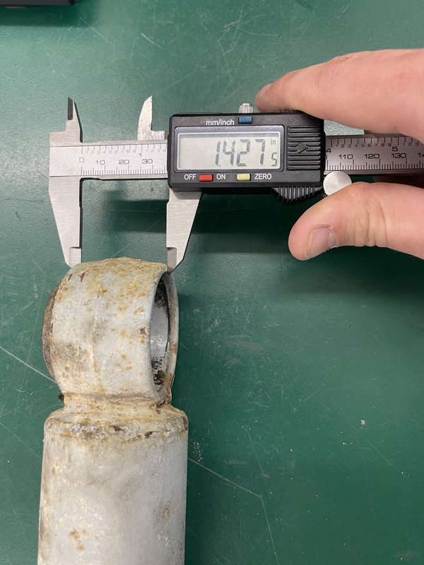

So after countless painstaking hours of research and discussion with a Koni CS rep I did indeed successfully identify the Shocks on the roland AND get some specs for a baseline:
Model-88 1006
MinL – 331mm (13.03”)
MaxL – 502mm (19.75”)
Dust cover OD x Shock body OD – 64mm x 55mm
Damping forces – Tested at .33m/sec (13in/sec)
Compression – 300N
Rebound – 3450N

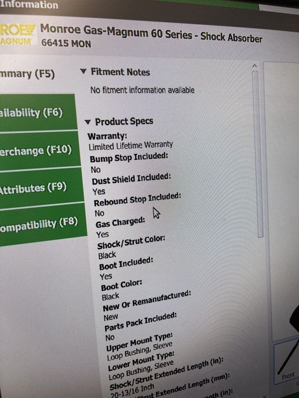

The 88 1006 went out of production in 2001 in Europe. The closest I have been able to find is this:
Brand:
Gabriel
Manufacturer's Part Number:
89461
Part Type:
Shocks and Struts
Product Line:
Gabriel Heavy-Duty Shocks
Summit Racing Part Number:
GAB-89461
UPC:
043645752651
Ride Height:
Custom
Extended Length (in.):
19.96
Collapsed Length (in.):
13.31
Adjustable Valving:
No
Gas Charged:
No
Upper Mount:
Eyelet
Lower Mount:
Eyelet
Bushing Material:
Rubber/Steel
Bushing Color:
Black
Boot Included:
Yes
Boot Color:
Blue
Body Diameter (in.):
2.370
Quantity:
Sold individually.

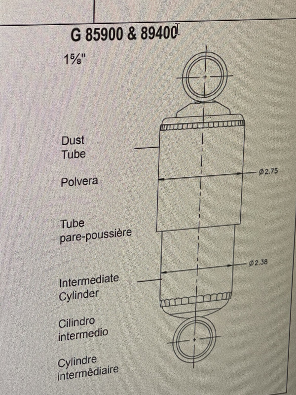

The upper OD is:
I checked front, rear, and in the front with the steering at full lock and no clearance issues what so ever. It's only .125 larger on both sides, 2.75 vs 2.51 OD. No issues with clearance at all. And unlike the brand Koni suggested to replace it this is only 80$ each shock. A bargain. The Koni 88s the CS rep suggested to replace the originals were about .75" larger so closer to not fitting and also 220$ each. The other models in the Gabriel 89400 model series were made for frieghtliners, class A motorhomes, GMC 4500/5000/5500 trucks, so I think these will be perfect for a "truck" grossing at 4700Kg max.

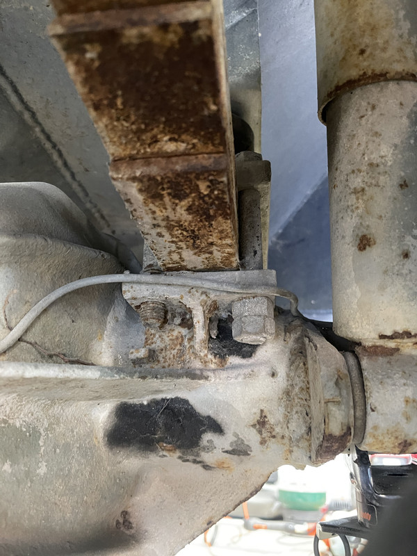

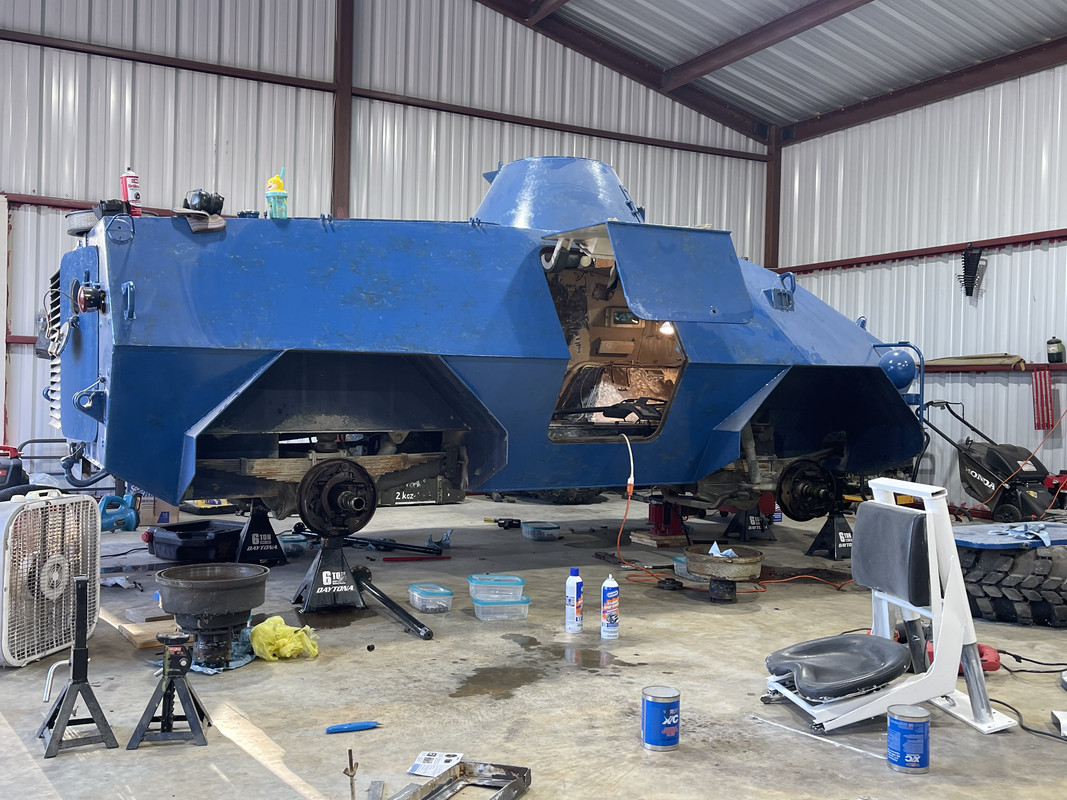

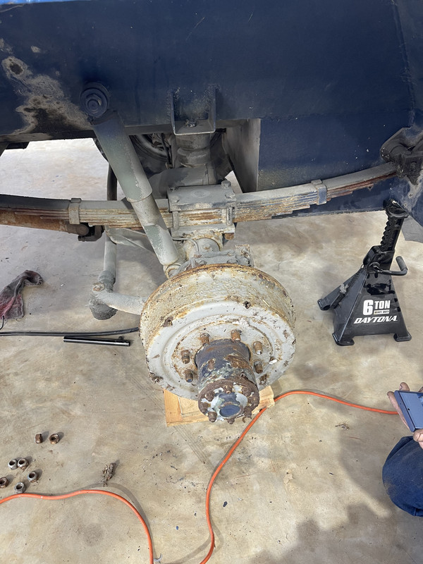

Not many updates since then but our plan is to have it ready by my birthday in July. Completely ready and the BRDM by the end of the year. Should be doable. This has been frustrating the holy hell bells out of me.
Since the last update I have gotten the springs re-arched to a more correct level of cushion and installed new shocks. Compare it to the ones earlier in the thread and it's night and day difference.
I realize my paintjob is absolutely atrocious. I realize now I should have left it alone and just focused on the mechanical bit.

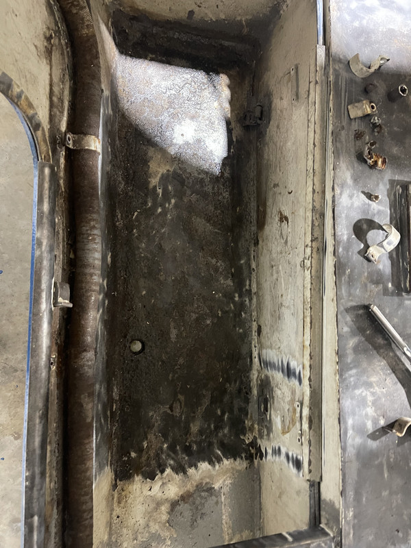

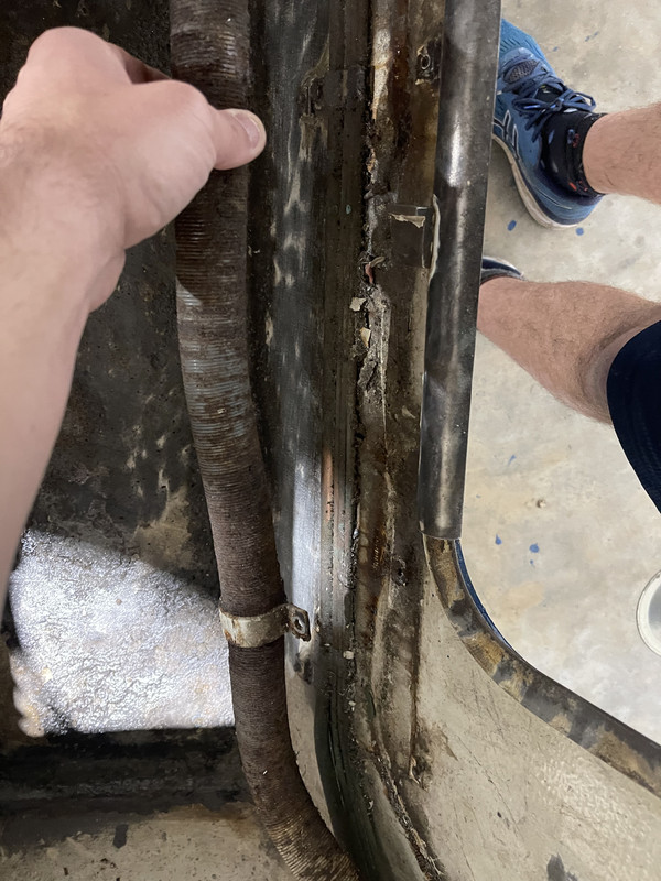

Thanks! I will have it sandblasted and primer and painted professionally later.
The roland sits about 6" higher with the same tires and re arched leaf springs and new shocks.
The front steering gear is out so I can repaint the front hull.
I dont know how well its sealed up, but it might be worth just sanding it down with a da. beacuse the sand blast sand will get in everywhere.
