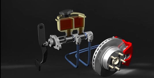

VEHICLE MAINTENANCE: BRAKE FLUID DOT 3, DOT 4, DOT 5.1, AND DOT 5
A vehicle’s braking system is a critical system for adjusting the speed of movement of the vehicle, or slowing down or stopping it. Brake fluid is a specialty fluid that ensures effective stopping power by transferring brake pedal force to the brake pads. It also has lubricating and anti-corrosion properties that improve the brake system’s functionality and performance and extend its operating life. All of these functions make brake fluid selection a particularly important task of vehicle maintenance.
Different types of brake fluids match the requirements of specific braking systems. The most common ones used today are DOT 3, DOT 4, DOT 5, and DOT 5.1 brake fluids.
Are all brake fluids the same? If not, what is the difference between these specialty fluids?
Here’s what you need to know.
WHAT ARE BRAKE FLUID MAJOR FEATURES?
The braking system is a mechanism with extreme operating temperatures. That is why the brake fluid needs to possess certain features to be able to meet those conditions. Moreover, its major features include:
  1. Non-compressibility - For effective force transfer
  2. Low viscosity - For compatibility with ABS
  3. Lubricity - For lubricating the sealings
  4. Corrosion resistance - For protecting braking system components
  5. High boiling point - For resisting high temperatures and not vaporizing, which would affect the transfer of the braking force.
