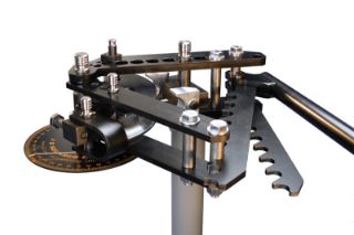

This might work and is not crazy money. Bought one for work and the thing is amazing.
Smallest die set for 1" tubing is 3" Center Line Radius - maybe that is small enough.
Come to think, I have something very similar out in one of my barns, mid century metal working tool that the wife picked up at auction and it came with a bunch of dies, now to try and find it though...
I can't remember the brand but it was still being made and many dies were available.
That bender is nice and if I was 30 years younger I would invest in one, unfortunately now I would never get the value back before the estate sale:cry:
EDIT, this is the model I have, not this one but one just like it, the search begins:)
dies with CLR on the 1" od from 2 1/4-8"
