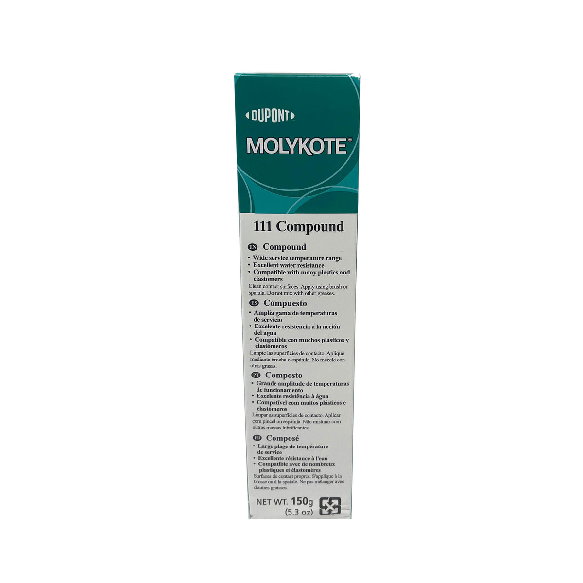

..... I'll probably think of more. Without fail all of these will need to be cleaned and/or tightened sooner or later. And get a star washer assortment, plus some Dow Corning Molykote 111 to protect them. Excellent dielectric grease and o-ring lube.

By the way, apparently you can't buy NYK77 in California:(
Dow Corning Molykote 111 is as good or better. NYK77 is just Truck Lite branded dielectric grease. Dow 111 is used extensively in the aviation world for this and for o-ring lube.
The four chems I keep on my truck tool box - loctite 545 (thread sealant), loctite 248 (blue threadlocker in gluestick format), DOW 111, and Permatex The Right Stuff Black.
