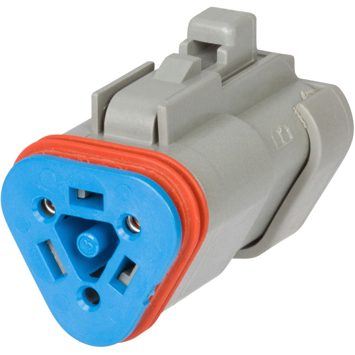

I have been through all the connections on transmission , inside kick panel disconnected reconnected ecu, looked inside ecu no corrosion, and front of truck connections, Keep getting code D1-6600 . Down shifts are pretty hard when I let off the gas all the way. 6600 is coming up as a serial communication issue. Any other places I should check? Found a schematic but not sure which wire is for communication.

That means the Allison computer has problems with it's J1939 bus communication. The FIRST thing to check is the resistance between CAN Hi and CAN Lo pins on the harness. If the coms bus termination resistors are blown, damaged, or missing that will take down the bus - probably the most common thing we see with A1/A1R/A1P2 trucks. The resistance between Hi and Lo should be 60 Ohms plus or minus 1-2 Ohms. If it's 120 Ohms you have one bad resistor, and if it's got really high resistance you likely have two bad resistors. One of the resistors lives under the PDP panel, and the other lives next to the engine ECM under the cab. They are 3-pin Deutsch connectors that appear to be a wiring harness "dust cap"..... like this:

Any J1939 bus wires going to any termination resistor or module. Easiest is probably the bus termination resistor next to the engine ECM - with that one unplugged you should see 120 ohms and the resistor itself should be 120 ohms.
Or you can front probe the databus connector on the dash. Just be careful not to spread the pins. Pins C and D.
Mis-spoke above in my first post...... The bus should be 60 Ohms with both resistors in place. 120 Ohms if one is bad, and infinity with both of them bad.

C and D show 60.25 OHMs.. Maybe a bad TCM?? , anyone have a tcm I can swap out and return for testing? They are on ebay for 800 or so. Dont mind spending it if it fixs it, but will loose sleep over it if it doesnt fix it.

Well the next step now that you know the bus is intact is to test for that same resistance at the TCM truck side connector CAN Hi and Lo pins. That will be at the WTEC III controller itself under the passenger side of the dash.

Ok , it has 3 plugs on it blue white and black not seeing a hi lo on the schematic

Sorry - Colloquial terminology for the CANBUS architecture - they are labeled J1939 Data Link (+) and J1939 Data Link (-)

TCM tested on black plug #13 and #29 shows 60.32 OHMS .. going to take a guess and say check engine ECU now?
Well - yes you could do that and probably should do that given it sounds like you don't have a diagnostic solution - the real first step and where I would go now is to hookup a laptop (or something like the Bluefire adapter and a phone/tablet) and see if the data it wants is actually on the bus. Throttle position should be displayed by any diagnostic reader in the live data. If throttle position is present then then next step would be to ensure the TCM has solid power and ground on all the appropriate power/ground pins from the harness..... assuming that checks out then you make the unenviable call that the TCM is likely damaged in terms of it's bus circuitry and will have to be replaced.
