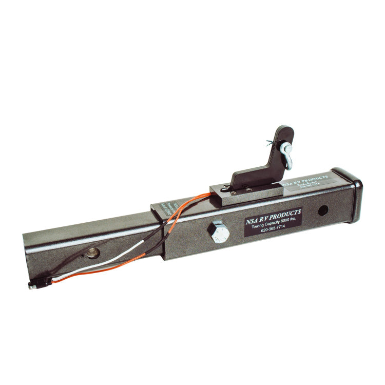

I swear by this system. No affiliation. Many options.
Mechanically activates towed vehicle brakes.
