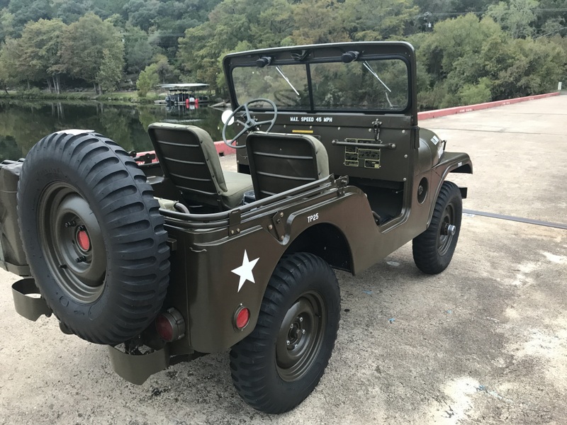

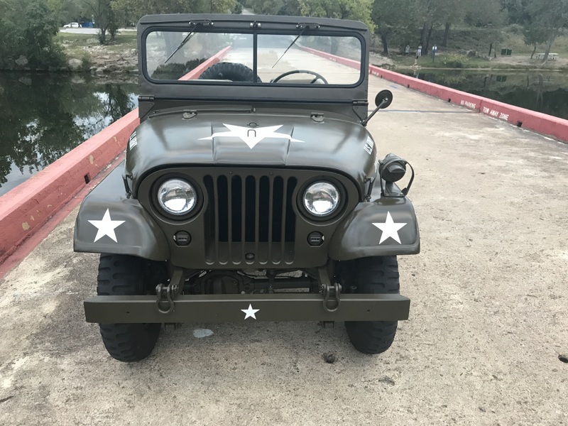

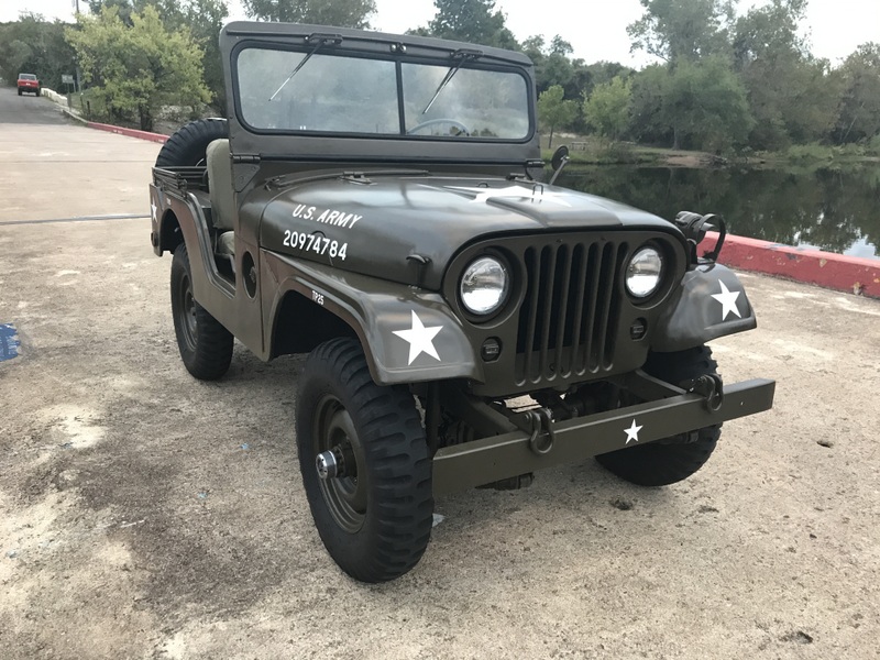

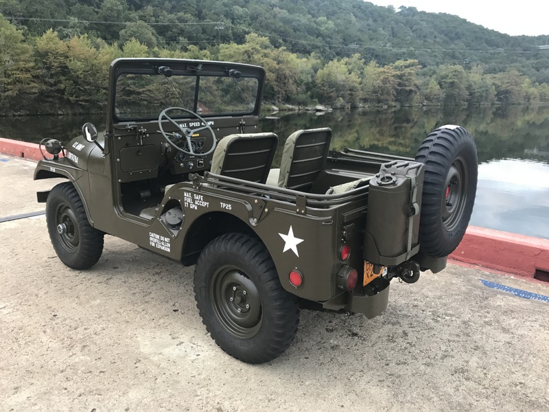

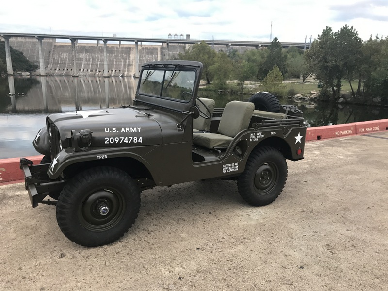

Thanks for the comments. I’m sure my son will enjoy them. He is a bit of perfectionist and this was his first vehicle rebuild. I hadn’t done one in about 30 years! We will have to post a pic or two of the before shot. Think drug out of a field and very rough. Saved running gear, fuel tank, rear springs, and either replaced or rebuilt everything else. Got lucky as engine was rebuilt back in 1961 according to tags. Does not smoke and was very clean inside when inspected.
jnissen
42
Austin/TX
Gillespie Coatings #24087 semi gloss olive drab. More earthy looking but period correct. Sprayed with 3M Accuspray using the orange 1.4mm head. Reduced 5:1 paint to Xylene.

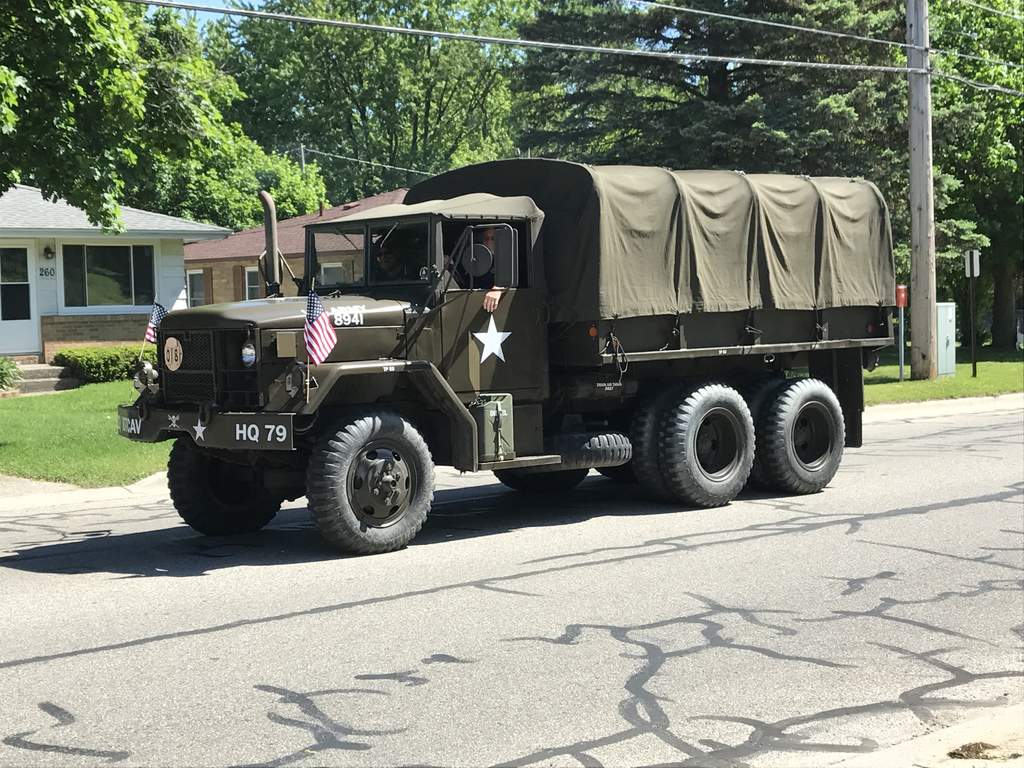

Gillespie is usually fine out in the weather, it's the Aervoe paint that doesn't do well when left outside, it tends to fade to pink. I painted my M715 with Gillespie in 2004 and it still looks great today and painted my deuce in 2005 and it had to spend a summer outdoor while I built a new barn a couple of years ago and it still looks decent.
