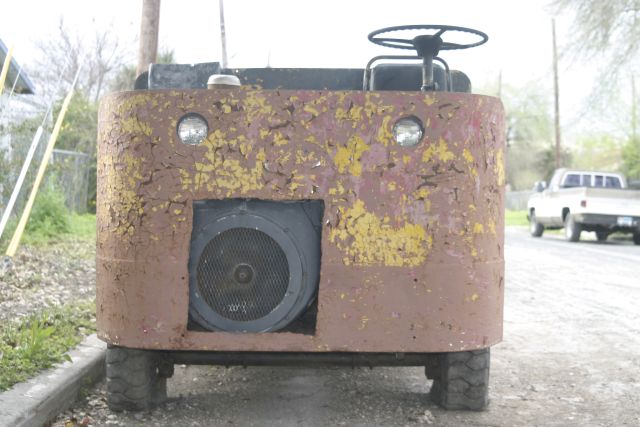

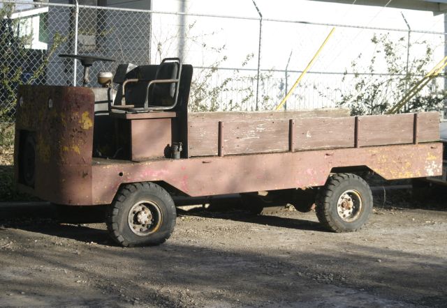

Figured I would start a build and documentation thread as this seems to be a pretty rare one.
It was bought by the po 30 or so years ago and used as a farm truck, about a year ago the clutch and brakes went and he couldn't find anyone to work on it. I ended up getting it onto the car hauler using a come along, tow chain, and loads of time.
Plans for it at the moment are:
Get engine running
Replace all wiring
Fix brakes
Fix clutch
Replace old wood
Repaint (probably cat yellow with 4" black lettering)
Rebuild the seat
Add a fire extinguisher
Do some upgrades to the engine, lighting, etc
This is going to be a severely limited budget restore.

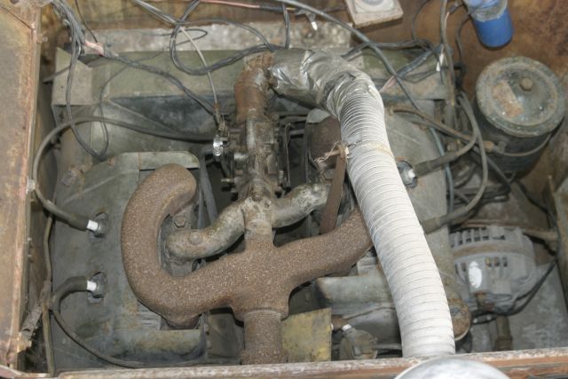

Engine is a Wisconsin VG4D governed to 2400 rpm, top speed of the vehicle is around 20mph.
Oil filter seems to be a Mil Std Jr, wix51100 was in stock at oreilly
Plugs are d167, picked up some compatible ones

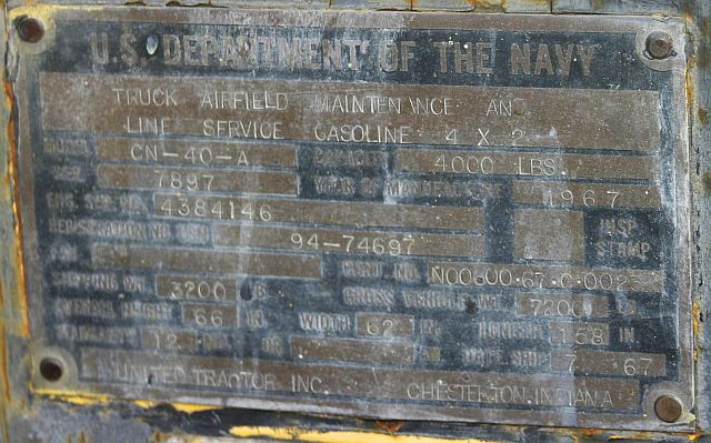

Data Plate transcription:
TRUCK AIRFIELD MAINTENANCE AND LINE SERVICE GASOLINE 4 X 2
MODEL: CN-40-A
CAPACITY: 4000 LBS.
SER.: 7897
YEAR OF MANUFACTURE: 1967
ENG. SER. NO: 4384146
REGISTRATION NO. USN: 94-74697
CONT. NO: N00600-67-C-0023
SHIPPING WT.: 3200 LB
GROSS VEHICLE WT.: 7200 LB
OVERALL HEIGHT: 66 IN
WIDTH: 62 IN
LENGTH: 158 IN
WARRANTY 12 MO
DATE SHIP: 7 67
UNITED TRACTOR INC. CHESTERTON, INDIANA

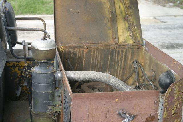

Today I changed the oil, changed the filter, lubed the cylinders, changed the plugs, drained about 3 gallons of water from the tank, and around 5 gallons of "fuel". Hit it with some starter fluid, and... she started. Tonight I have the battery charging and will be picking up some more fuel, tomorrow I am hoping to have it moving (even if i have to start it in gear).

I am thinking that the optional starter that was replaced has suffered water damage, was mounted incorrectly, or has the wrong head on it. Will worry about that later as well.
After I get it started and moved to the work location, I want to see how much of the ngine compartment can be dismantled to make maintenance easier.

southdave: It was a 6v positive ground system, so far I have chopped three sets of wiring out of it with bolt cutters.. Partially melted original wiring, partially melted second set of wiring, and all of the wiring used to do the 12v conversion. The only thing I know (tentatively) about the rear end so far is it is made by United Tractor.
Last night I was tired of not working on it, so... Attached a drop light to the tree, grabbed the battery from the rv, and started working on it, gave up around midnight.
