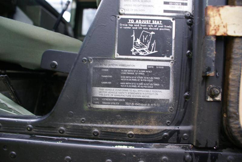

1991 M998
No bumper
VIN: 137XE8237MB112619
Possible Fl Airport
What can you find?
Thanks
Spin
That's not any serial number series for any M998 that I've ever seen. Are you sure it started off life as a military one? Or could it be USMC or USAF?
That is the VIN I got from DicedDeuceman (Dave) I can attach a pic of the data plate..
Spin
NPS 00002458
Maybe AF? I think, It was originally GREEN like DAY-GLO EMERGENCY GREEN...LOL
