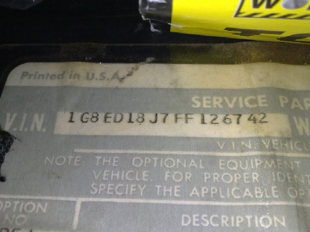

Ok troops the plot thickins....... upon examination of my vin code using the sites vin code decoder it told me i was rolling around in a one ton pick up:confused:
At some stage somone changed the data plates....
The real no was located on the build sheet in the glovebox, it read
1G8ED18J7FF126742
This also means the reg on that plate aint mine either...... bummer.
This vin number checks out, most uk blazers were used on us air bases in the uk or in Germany. If anyone else has anything to add id be gratefull:|
1G8ED18J7FF126742
Cease fire freeze. The glove box can easily be changed. Only one way to do this for sure. Check the vin plate on the drivers side dash. It's in the very far left corner where the dash and windshield meet. You need to validate your VIN there. Then we will proceed.
As for CUCV's in German, a lot were used by the Army in Germany. Nearly every unit above the combat brigade level had them instead of the M151's. I went from a armor battalion to a forward support battalion just prior to desert storm. The armor had just transitioned from 151's to HMMWV's. The support battalion had 2 HMMWVs and the rest were CUCV's. Oh the ambulances were HMMWV's ambulances though.
OK, checked vin plate on dash, not there but the vin tag for the pick up vin no was loose in the glove box when i bought it.
This means that someone in its past swopped vin plates, for why is this:confused: guess we,ll never know.
Having said that i still reckon the glove box vin is the real deal.
One last thing, has anyone started a picture thread for cucv,s while in military service????
P.S thanks for the info CARNAC.
