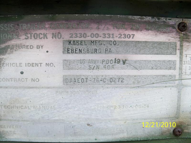

Hi CARNAC wondering if you can help me with a PU-650B/G (MEP-006a w/m200a1) info.
Item: M200a1 Generator Trailer
a. Serial Number (VIN number)- PD019V404 (I included the dataplate pic)
b. Registration Number -----none
c. NSN without dashes -----6115002581622
d. Where you bought it----JBLM (formerly Fort Lewis)
Contract # DAA07-76-C-0272
No info. The serial number provided is for the trailer chassis. There should be another one with the data plate that has the same NSN as the trailer system ie 6115002581622.
