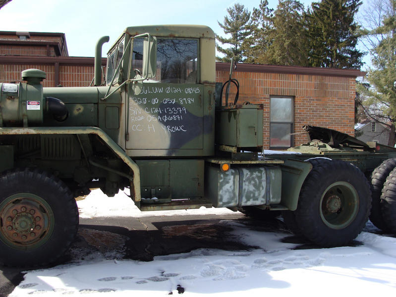

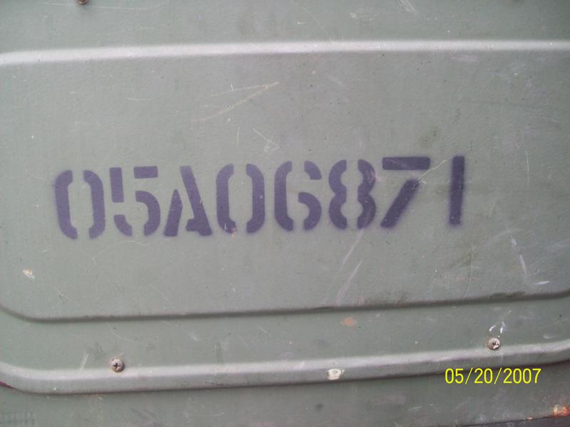

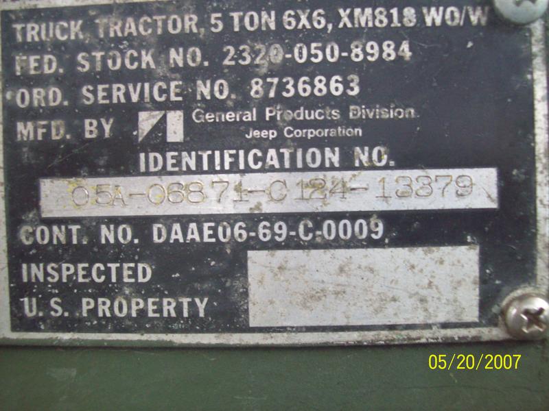

a. Serial Number--UNABLE TO FIND ON THE FRAME AT THIS TIME
b. Registration Number -----05A06871C12413379
c. NSN without dashes -----2320000508984
d. Where you bought it--LANSING, MI.- preacherboy bought it from gl, I bought it from him
e. Bumper numbers--This was on the in side off the door 05A06871
The truck is a 1970 kaiser jeep m818 with out winch according to the MI. title

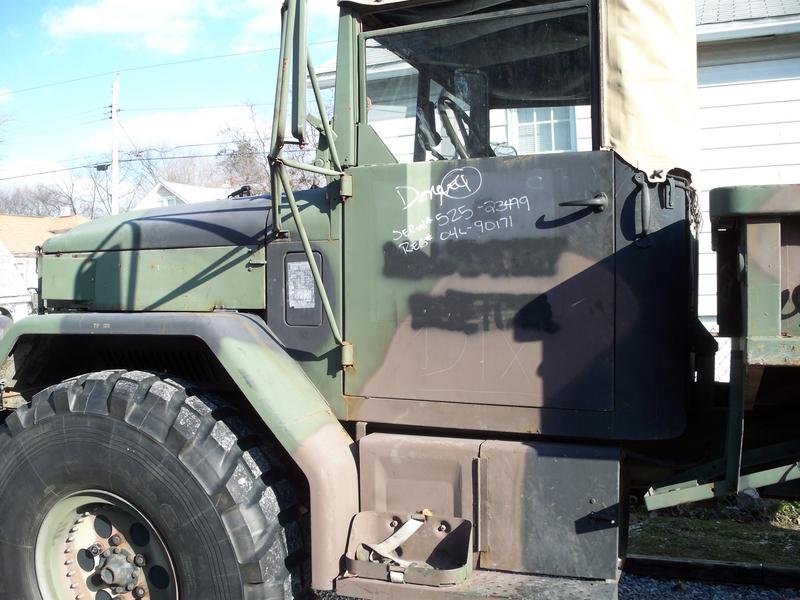

OK, here is my info from the ID tag and was inked on the drivers door + a shipping label on drivers vent. Name stenciled on windshield is: SSG Bauerlein . Truck is a 1971 M35a2 WOW
serial # 52532499
reg # 04L90171
NSN # 23200771616
Purchased from private owner in Chantilly, VA
Thanx in advance.
Nomenclature:
TRUCK TRACTOR 5-TON Model:
M818 NSN:
2320000508984 Serial Number:
C12413379 Registration Number:
5A06871 Year of Mfg:
1971
Sep 2005 info
It appears it was at one point with B Company 158th Aviation Regiment out of Camp Marby Tx
