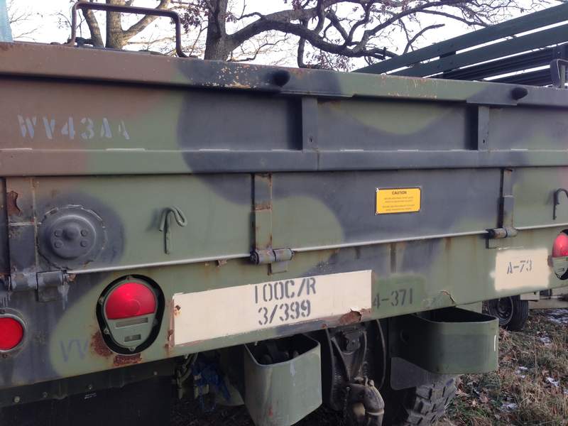

image.jpgCarnac need help to determine where my M925A2 is from, I will gladly donate.
Thank you in advance!
The information as follows:
1991 BMY HARSCO M925A2
A) VIN: 2501194
B) Registration: Does not have one
C) NSN: 2320012300308
D) Where Bought: Ft. McCoy, WI
E) Bumper Numbers: 100C/R 3/399 (drivers side). A-73 (Passenger side).
F) Contract #: DAA0786CJ111
G)Date Mf'd: 10/1991

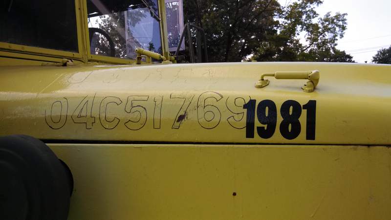

Would you please work your magic on the information that I have for my M35A2 (without a winch)?
The data plate on the dash board was removed at some point before I took ownership. I got the V.I.N. from the frame and it matches the V.I.N. the government put on the paperwork. The registration number was traced out under layers of paint on the hood; see photo. There was not any numbers visible on the inside of the driver's door.
A). V.I.N.: 042516035
B). Registration number: 04c51769
C). NSN: 2320000771616
D). Where I bought it?: GSAauctions.gov It was owned by the U.S. Forest Service, who loaned it to the Michigan Dept. of Natural Resources. The Michigan D.N.R. loaned/assigned it to the Holton, Michigan Fire Department. I was told it was not going to be "reassigned" due to the fact it was a manual transmission and it was put up for auction.
E.) Bumper numbers: None. Painted over too many times.
Thanks in advance,
Donation made,
M.J.

Carnac,
Thanks in advance,
Donation made,
M.J.
No unit name but there was a unit id code. Might be able to run it on google and find something or contact the
Unit Ident Code:
WRK9B0
Nomenclature:
TRUCK CARGO 2-1/2T Model:
M35A2 NSN:
2320000771616
Serial Number:
42516035 Registration Number:
4C51769 Year of Mfg:
1969
Manufacturer:
65909
Info Sep 2005

View attachment 466067Carnac need help to determine where my M925A2 is from, I will gladly donate.
A) VIN: 2501194
Organization:
3D BATTALION 399TH REGIMENT LS DETACHMENT 2
Location:
FT MCCOY
WI
Nomenclature:
TRUCK CARGO D/S 5-TON Model:
M925A2 NSN:
2320012300308
Serial Number:
2501194 Registration Number:
NL14SN Year of Mfg:
1991
Manufacturer:
47457 Contract Number:
DAAE07-86-C-J111
Info April 2009
