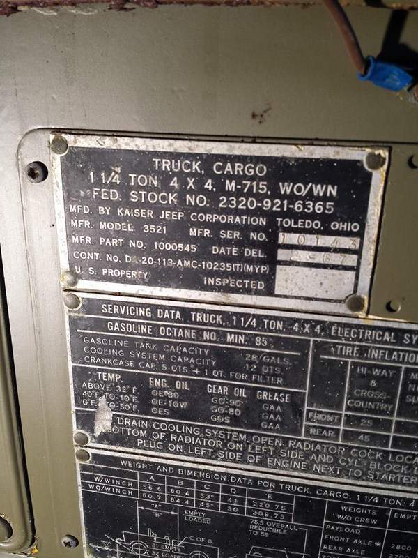

Here is what I have for my M715. If you need me to provide more info let me know and I will search the vehicle for what ever I can to assist you. I plan on doing a restore and it would be amazing to have ANY history on this vehicle. Thank you Sir
A)serial 10143
B)NSN I think? 23209216365
Took it in trade in Ohio
Do not have bumper number
Go back and read post #1 and follow directions. United States is a big place. Have your location posted.
