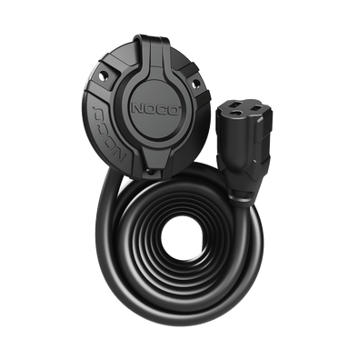

So I’m looking for guidance on what to purchase when it comes to a 24v battery maintainer and shoreline plug. I’d like to be able to plug my hmmwv into an extension cord to keep the batteries charged. Tired of removing the seat and disconnecting battery terminals. I don’t have any accessories. I’ve seen and like the idea of a shoreline plug at the rear where the hole is for antenna wiring. Also wondering if anyone has been able to modify a slave cable to make this happen.

So I'm slightly confused with what you are trying to say/accomplish.
You mention adding a battery maintainer, and I assume to wire it in using a shore power type inlet plug at the rear of the truck requiring you to run a power cable from wherever you mount the maintainer in the truck to that inlet plug.
I understand all of that part.
I'm just confused where the slave cable comes into this?
If you're adding a plug to the truck body there should be no need for anything slave cable related as you're making an independent system.
Also to note, it's unlikely that you will find a power inlet that won't require a much larger hole than the one used for the radio cable, so you'll end up enlarging the hole to around 2" for most marine style 115V AC inlets.

The other method to charge these is just use a regular 24V charger with an adapter that lets it plug into the slave port so the seat doesn't need to be removed.
example
(this one requires specific charger to plug into, but it's not hard to make one)
https://blackdogcustoms.com/product/noco-charger-nato-adapter-cable/
It's basically just this cable with the no.co plug attached (and a big markup)

I'll just tell you what I did and you can think about it...
First, I bought a NATO slave plug so that I could plug the truck in without messing with the seat. They can be pricey but a careful watch on the evil auction site turns them up for reasonable prices.
Second, I bought a 24v battery tender. I bought a NOCO Genius smart tender. It's got electronics to prevent overcharging. It's 7.4 amps, so it's plenty strong enough to charge up both batteries quickly if they happen to both be low. And yes, the NOCO "remembers" its last setting, so when it gets plugged in it's already at 24v without me doing anything.
Third, I bought a "battery balancer" that maintains the charge level between the two batteries. This keeps the charger from charging one battery to "full" and leaving the other partially charged. It has the same effect on the voltage coming from the alternator, which is a plus. Batteries wired in series can have this "one isn't charging fully" problem.
I put all the electronics and connections in a waterproof box (a Harrdig-like case) with grommets that allow a 120v plug (to plug the system into the wall), and the heavy-duty cable with the NATO slave plug attached to exit the box. Also, I have another 120v plug on the end of a cable that reaches to my engine block heater.
In the summer I plug the truck in overnight about once a week, maybe every other week. In the winter I plug it in every other night or third night. Sometimes I plug it in to the block heater if I know I'm going out the next day.
In two years the batteries (cheap Wallyworld ones) have held up fine and the truck sat for three weeks this Fall while I was out of town and started right up, so I know this setup isn't killing the batteries.
Hope this helps.

can I get your parts list on this.. fuse holder, voltage converter, and charger. wire gauges.. ect.. looks like a Genius, blue sea and converter ? Thx
1...Orion 24/12-70A DC/DC Converter, 2...ST Blade Fuse Box, 3... NOCO Genius G15000 12V/24V 15 Amp Pro-Series Battery Charger and Maintainer,
4...NOCO GCP1 15 Amp 125V AC Port Plug Power Inlet with 16-Inch Integrated Extension Cord. 5...Wiring harness from Black Dog Customs. ( Money Well Spent ). Everything can be purchased on Amazon other than Black Dog Customs wiring harness.

I resurrect this old thread but will add what I did in-case it helps someone.
I got a NOCO GENIUS GEN5X2, 2-Bank, 10-Amp (5-Amp Per Bank) Fully-Automatic Smart Marine Charger and mounted it behind the front seat battery compartment and fished the leads through a convenient hole there into the battery compartment. One lead to the + and - to each battery. There is also a cheaper 2 amp version available also which is cheaper.
For power access, I installed NOCO GCP1 15 Amp AC Port Plug, 125 Volt Power Inlet Socket, and Waterproof Electrical Outlet Receptacle Box behind the rear seat where again, there is a convenient unused port which is almost the perfect size for a 110 outlet. I used some rubber material to make it water proof. Yes, I know, a lot of water will hit it, but this makes it very convenient to plug it in from the outside of the vehicle without drilling new holes.
