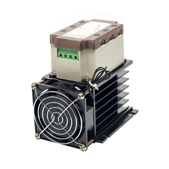

I did find a 3ph power controller up to 24kw, regulating voltage. Is this what you are referring to as a voltage regulator?

Automatic Voltage Regulator. It drives the field current on the generator.
This is an example of a cheap one. This one will have limited boost for starting big motors.
Here is an example of a more premium regulator.
