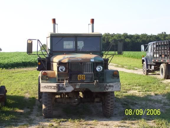

This is a 1970 AM GENERAL 6X6 with a 440 MOPAR BIG BLOCK, 727 AUTOMATIC TRANS, DUAL 5" EXHAUST STACKS with FLAME THROWERS
http://i15.photobucket.com/albums/a380/redimperial601/100_2711.jpg
here is an update on Lukes dodge 6x6
he added 46" Michelin XL Military tires to the spec list
http://i20.photobucket.com/albums/b213/frankrizzo1972/lukewith46s.jpg
http://i20.photobucket.com/albums/b213/frankrizzo1972/lukewith46s2.jpg
http://i20.photobucket.com/albums/b213/frankrizzo1972/lukewith46s3.jpg

cheeeze louize!! how much clearance is there between the rears? I'd be fraid of twisting an axle, but that's really cool!
rizzo
2,841
Port Huron, MI
Re: RE: 46" XL
2 inches (twice the clearance on my 5tons with 1600's), the deuce has a 48" inch spread.
these tires came off of deuces in the military (or so I'm told)
mudboggers run alot bigger tires than that on deuce axles.

How they/you do dat?
So these are stock M35 rims, rear hubs flipped,an inner tire removed? What all did you guys do?
I thought by doing this you put to much pressure on the outside wheel bearing because of the offset? Do explain a little if you can. I have been looking for some 135 rims for my M109..
rizzo
2,841
Port Huron, MI
Re: How they/you do dat?
he didn't flip the rear hubs. I don't think he is worried about the outer bearing. Some other guys have done the same thing, but with smaller tires.

did you get a chance to see the suspension work as he drove over stuff(did they rub on the bed or in the front fenders?)
rizzo
2,841
Port Huron, MI
Re: RE: Re: How they/you do dat?
the left front tire will rub on the drag link when turned hard right.
he did not drive over anything that would make the rear flex, but we are gonna take it to my bog in the next week and try out the tires. I will have him drive over the hills and watch the flex
