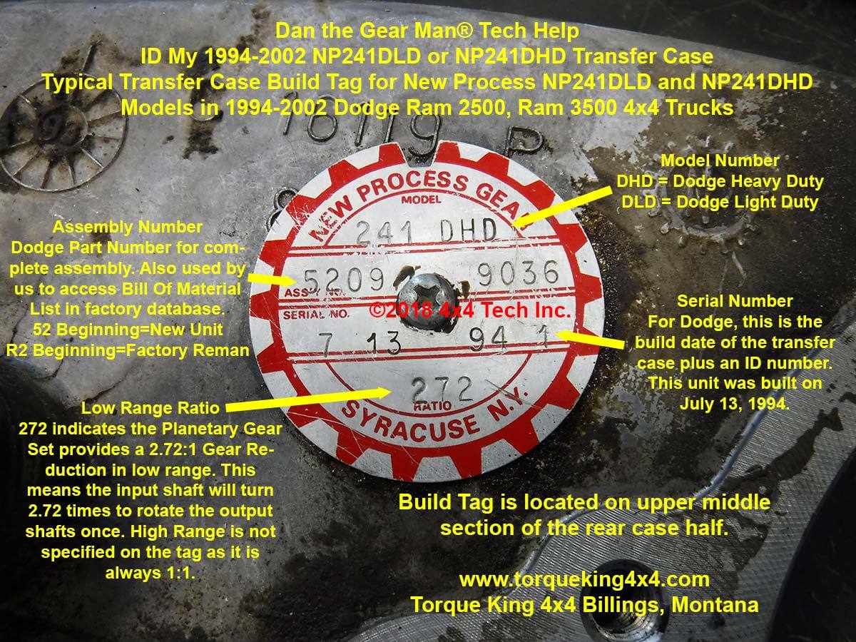

According to the parts manual, the unit is considered an H13 (basic unit). The manual shows a 12447125/2520014092512, but only if kit 57K3498 is installed. How do you know if it is installed?, and what is the part number if it isn't installed?
Looks like there are (2) types that it could be (218 or 242). Based on searching, looks like the 242 is much more popular.

If it has a slip yoke on the rear shaft it is a NP-242, if not it is a NP-218.

H13 would be an M998A0 truck, which I believe are from before 92. If yours is a 94 then at minimum it should be an A1 or possibly an A2 variant.
If you have a 3 speed M998 then it's probably the NP218
If it's a 4 speed then it's the 242
If your truck really is an M998 not an A1 then likely 94 is when it was rebuilt.
What is the serial number of the truck?

it is a 3 spd

That serial number would put it as a manufacture date of around 1988, so it would be an A0 truck, not an A1.
unless they did some type of retrofit, it's extremely unlikely to be anything other than the 218

I don't recall off hand but i think it is towards the back on the side.
See this link for a pic of what you are hunting

There is no such thing as an A0, it is called a BASIC, there will be no suffix on a basic, IE M998 not M998A1.
But because it was rebuilt in 2008 it possibly has a NP242 transfer case because by then the NP218 was no longer available, it might have a 6.5L in it also easy to ID looking at the way the tach drive is bolted on the back of the block.
Just slide under it and see if it has a slip yoke tail piece on the back of the TC, that will settle if it has a 218 or 242.
On any rebuild you will have to do some investigation to see what components they used when rebuilding the truck.

I am curious where you got that it was a 1994, the serial number is for a 1989
