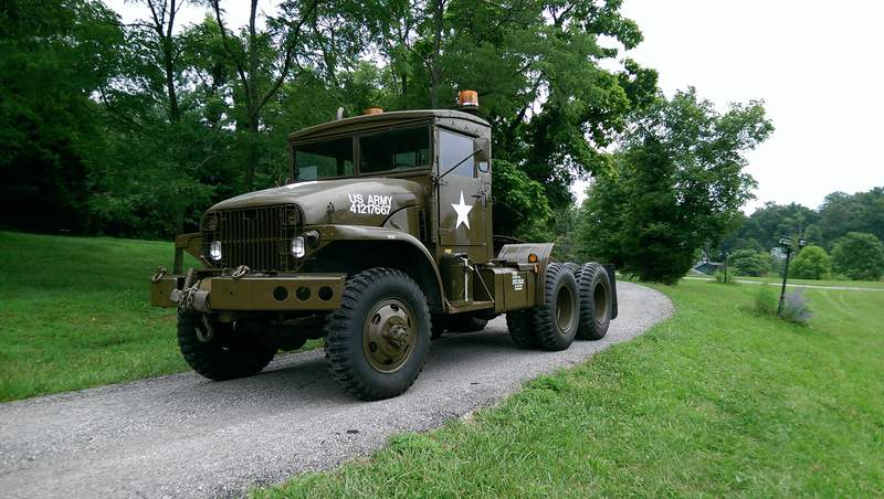

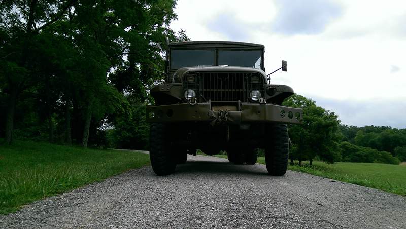

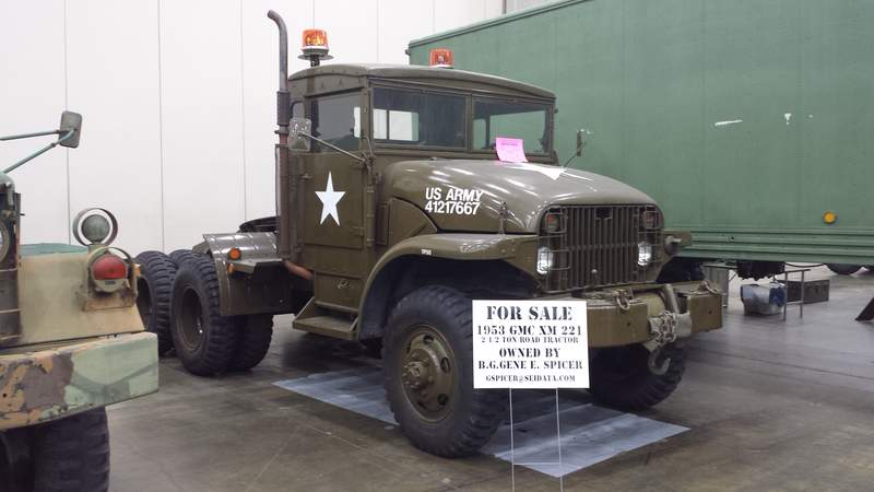

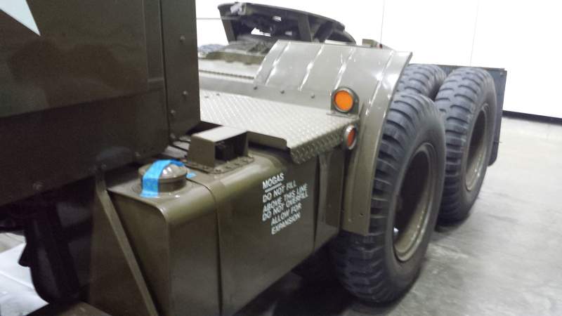

It is a beautiful truck. Dawn and I spent a lot of time looking at it. Really nice. We have a friend who has one and he wanted a bunch of pics so I shot a ton for him. Here's what I got (I hope I am not overstepping my bounds here-if you want me to remove them, I will happily).
Congrats, it really is a gorgeous truck. It's probably one of the nicest 135/211 series trucks in the world.

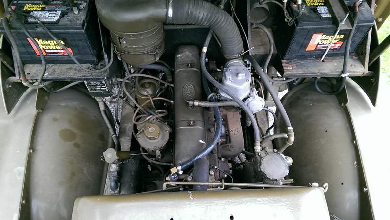

To start out a little rough.
It flooded from time to time and had a good oil leek.
And to top it off it has the same problem as all of my other 4+ wheeled vehicles had when I first got them. Transmission problems!
After cleaning the float bowl and installing a fuel filter it ran great. I still drained the tank and flushed the lines out.

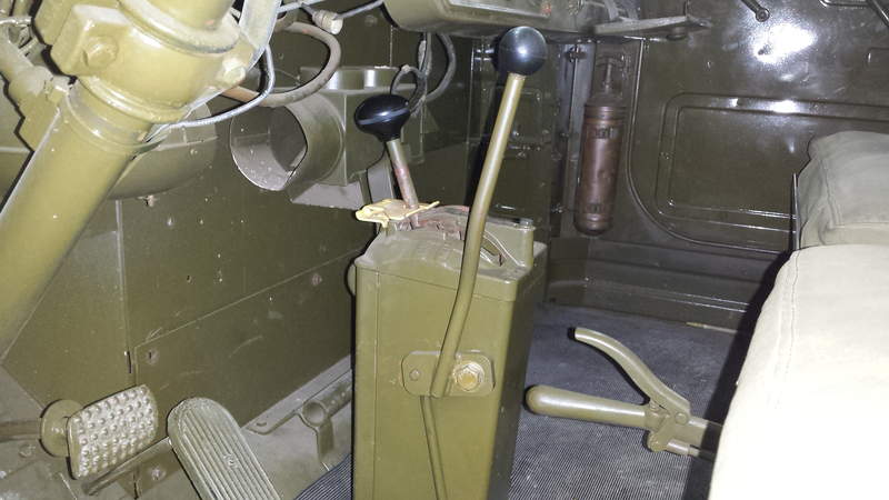

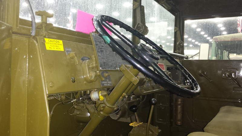

I checked the TM's and it just says "notify ordnance maintenance personnel". After you do that we should be able to just jump in and drive.
I have not had that symptom and it's not in the manual. Your truck has an extra funky handle on the side of the shift tower that I understand is the REB shifter. http://www.alfaheaven.com/MilitarySection/6x6 Trucks/HydramaticHvn.html
I was hoping you'd be able to tell us how it works different than the 'original' automatic and how the linkage is set-up........and now we're both choked that it's not working.
I'm no mechanic but I've managed to adjust my linkage, replace worn pins, clean the oilpan oil screen assembly and thinking I'm real lucky to still have a working transmission. I have heard of one transmission that was torn down after running atf that showed signs of unusual wear. I also understand that seals do not like sitting and should be driven weekly to A&W to reduce oil drips on pavement.
I hope you get the chance to do that.....and get some pics of her at the golf course, great truck.
Greatly appreciate the pictures.
Matt1970M35A
258
Charlestown In.
Yes the extra knob on the shift tower is a rab shifter.
It lets you shift the transmission manually. With it installed the transmission is no longer an automatic.
The only thing to do now is a rebuild.
