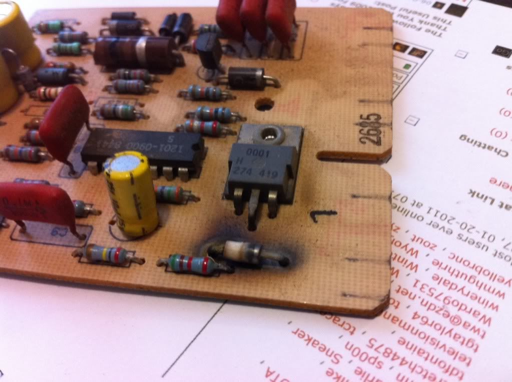

A picture of my fried Glow Plug Card
cmroles
127
Phoenix, AZ

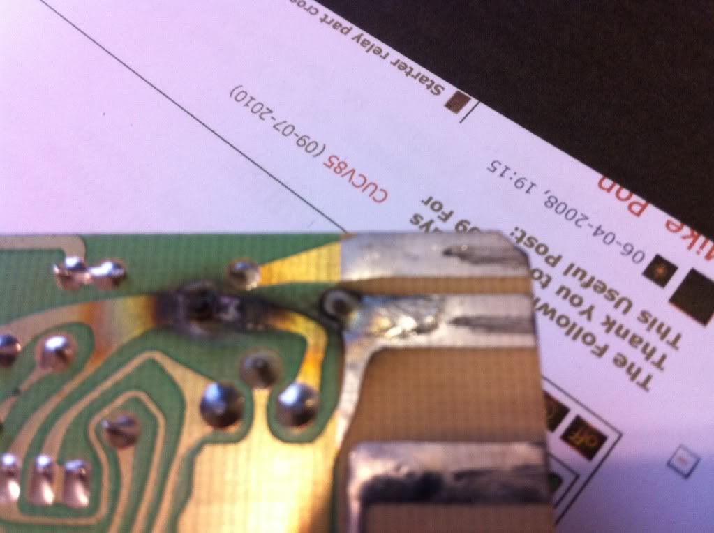

I checked continuity of glow plugs and it passed. I then yanked my card to discover this, argh! http://i149.photobucket.com/albums/s62/raf32/glowplugcard.jpg?t=1297118811
How do I put a manual switch to heat the glow plugs, there is no way I'm paying $500 for a card.
That board may be repairable if you have a little electronic knowledge (or know someone who does).
The component that fried is likely available from a Radio Shack (assuming you have one that still sells actual electronics and not just cell phones), and the burned traces can be patched with some small jumper wires soldered in. We used to do this on commo gear all the time when I was in the Service.
May be able to fix for only a few bucks, you never know!

i believe thats what happens when you have multiple bad glow plugs and the working ones get more voltage and blow the card. Thats why a 12v GPR supply is a good choice.
dstang97
1,859
30
Clover, SC
I tried to repair mine but could not find the correct resistor at radio shack. I was told it is a 24v 1watt resistor.
