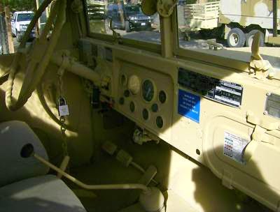

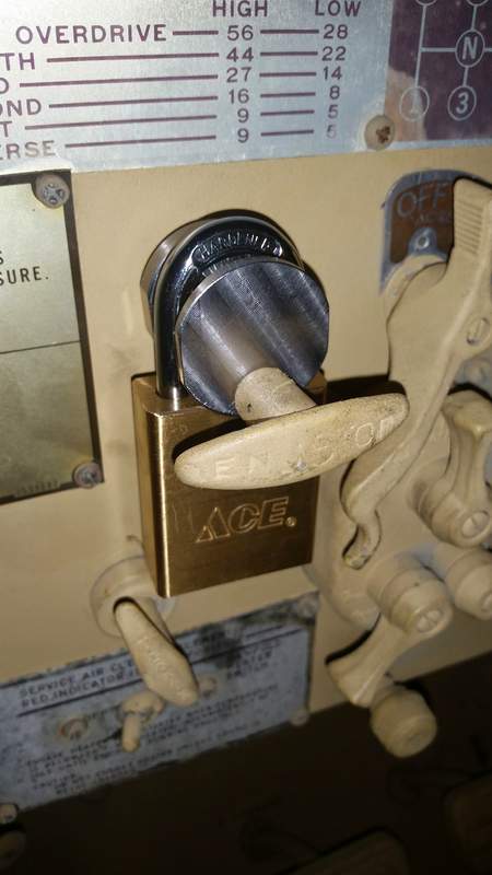

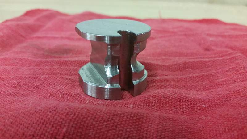

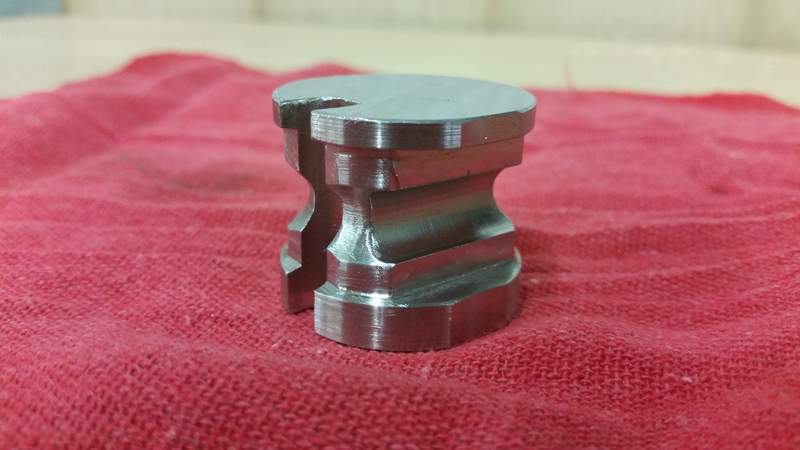

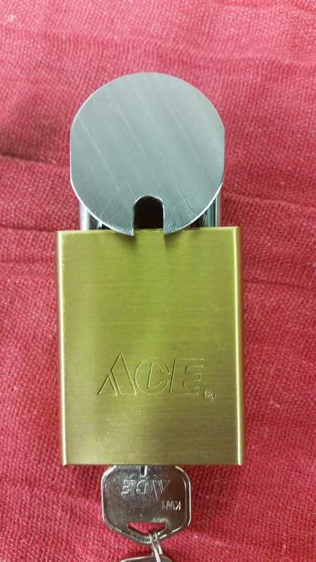

The very first thing I did for my "new to me" Deuce is I machined a small lock for the shut down knob, I have seen a couple of variations of this idea here on SS, this is just my version of the same thing. I used some stainless steel I had laying around the shop. I made it to only go together one way with relatively close tolerances so it is not loose fitting. Also I wanted the loop of the lock to recess into the machined part so it could not be cut with a bolt cutter very easily.

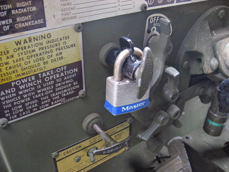

The first picture is the picture that gave me the idea. I am not sure whose truck it is.... but, thank you for the idea!
Please feel free to let me know what you think on this or any other future ideas, I am always open to a fresh perspective.

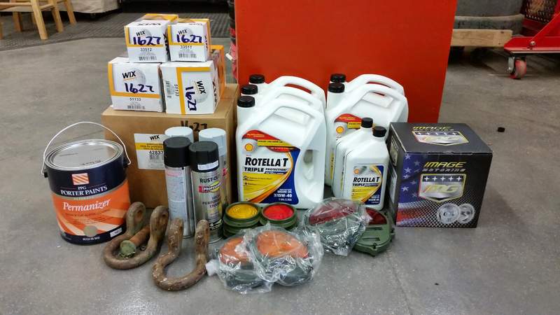

Out of town last weekend so I have collected a pile of goodies for the Deuce. This will be my work for the weekend... and maybe on into the week a little. In addition to what is in the picture I also have all new wood & nuts & bolts for the troop seats. The last thing i have coming is i haved all the stenciles being made to paint all of the markings on the truck, the: "Tire preasue", "drain air tanks", "do not fill above line", etc...
After changing the oil I will be taking 61sleepercabs advice, I have contacted the CAT Dealer I have had dealings with for many years, they will do the aforementioned "Engine Oil Analysis" for $12.50. For that kind of $$ I don't think I can afford not to do it.... every time I change the oil! For no more than the truck will be driven I think that will be a cheap way to keep an eye on what is going on inside and hopefully head off any potential problems before they become major issues.

I think you covered a lot of primary bases @ once. Nice machine work on your engine kill locking setup, by the way. Keep us informed as to your improvements & other ideas!
TM's say to never park the truck in gear, due to a startup condition happening if the truck get bumped. With your engine kill lockout, it can't start period. A good safety device for lots of reasons!

Very nice truck and have fun!! The list of what to do and what is done will get longer before it gets shorter. I don't know how hard it was to machine that lock block but if you ever do choose to start making them and selling them please let me know as I'll be in as well. Great idea and for those of us who can't/don't have the tools or skills to do it will happily buy one.

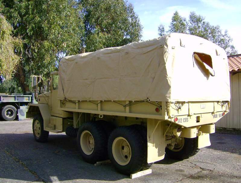

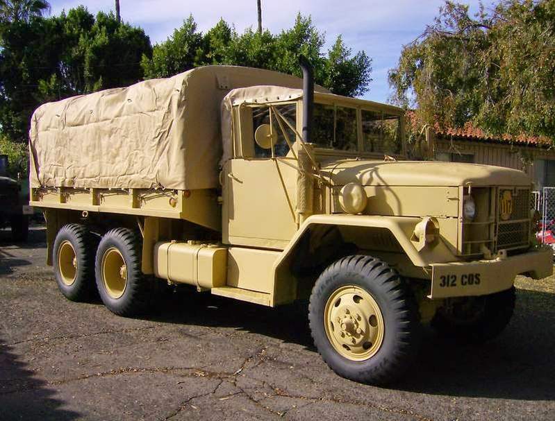

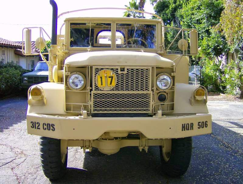

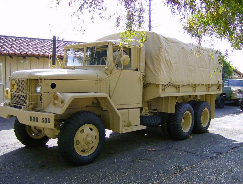

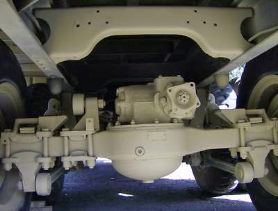

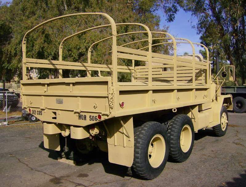

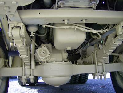

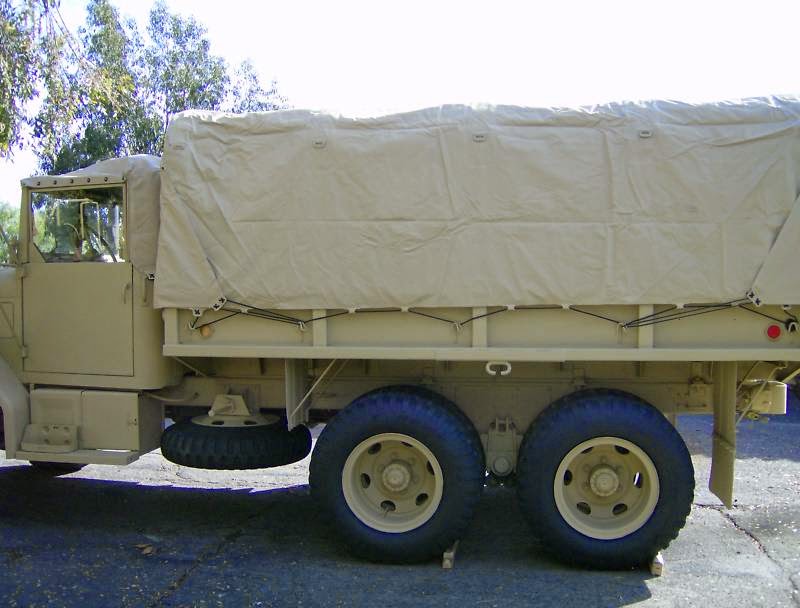

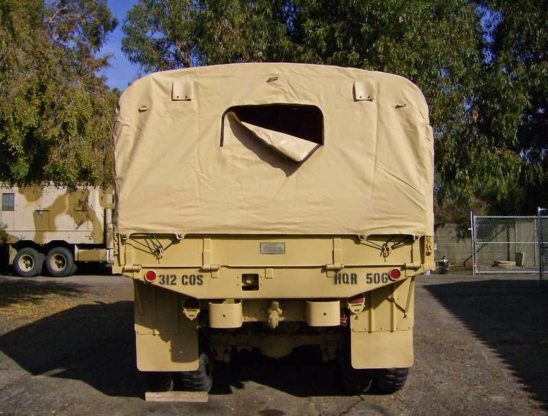

Here are some of the pictures as it was when I picked it up. I post these for 2 reasons.
1) I want to show off my new toy and have something to compare against as I make parts and make improvements.
&2) I love for some of you guys to chime in if you can tell me what MV dealer these pictures were taken at? These pictures were taken at the MV dealer in CA that the owner I bought it from bought it from.
I would love to contact the original seller about what was done, or not & to simply learn more about the truck in general.
Thanks in advance!
Joe

Definitely not new, it just has a fairly fresh coat of paint. It is rougher in person than it looks in the pics. It does have 18,500 miles and around 400 hours on it.
