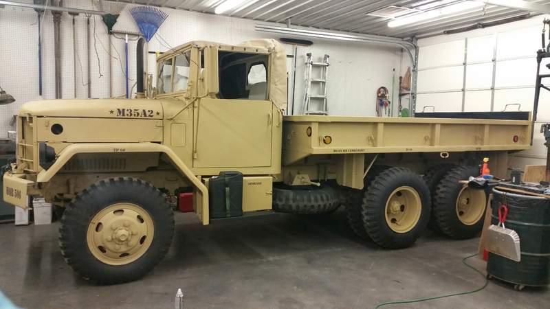

Your truck was very well painted tan & you have made it that much nicer with the added stenciling. Keep your mechanical side up as well & you will have a top notch truck that will take you most anywhere you want to go, plus stop for any emergency along the way. I have an '87 that was painted the same way, but nowhere near as nice as it is an Army paint job with the entire bottom painted black. Thanks for posting your pictures & work in progress.

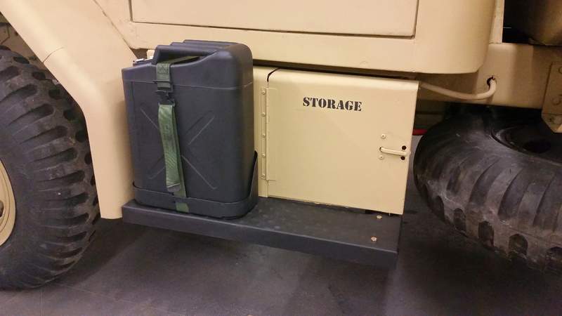

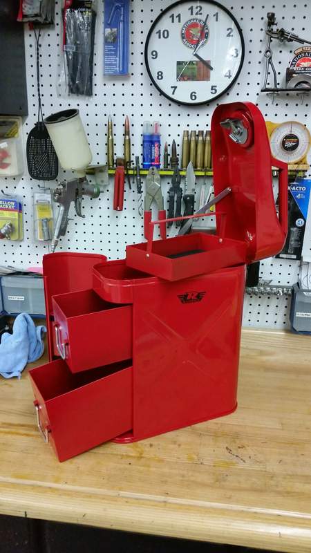

Today I finished up media blasting 6,7,8? layers of paint off the steps and Jerry can holder, also media blasted the jerry can tool box (just couldn't do the red) My truck was missing the jerry can all together and I didn't think I really need a real jerry can to ru around town, the tool box seemed to make more sinice.

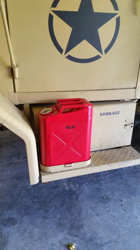

Some clown is going to be PO'ed, when they try & steal your fuel can, only to find that it is a tool & parts carrier. Never saw that before, quite a novel idea...

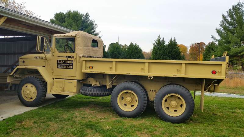

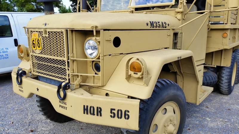

Where did you get the stencels??
I made them myself, I have vinyl wrap that would be normally used to wrap an entire vehicle. I used a vinyl die cutter that would usually be used to cut stickers for windows or such. I cut all the lettering and weeded out the letters themselves in turn making stencils. By doing it this way, when you put the stickers on the truck and paint them you end up with really crisp edges on all of your lettering.
