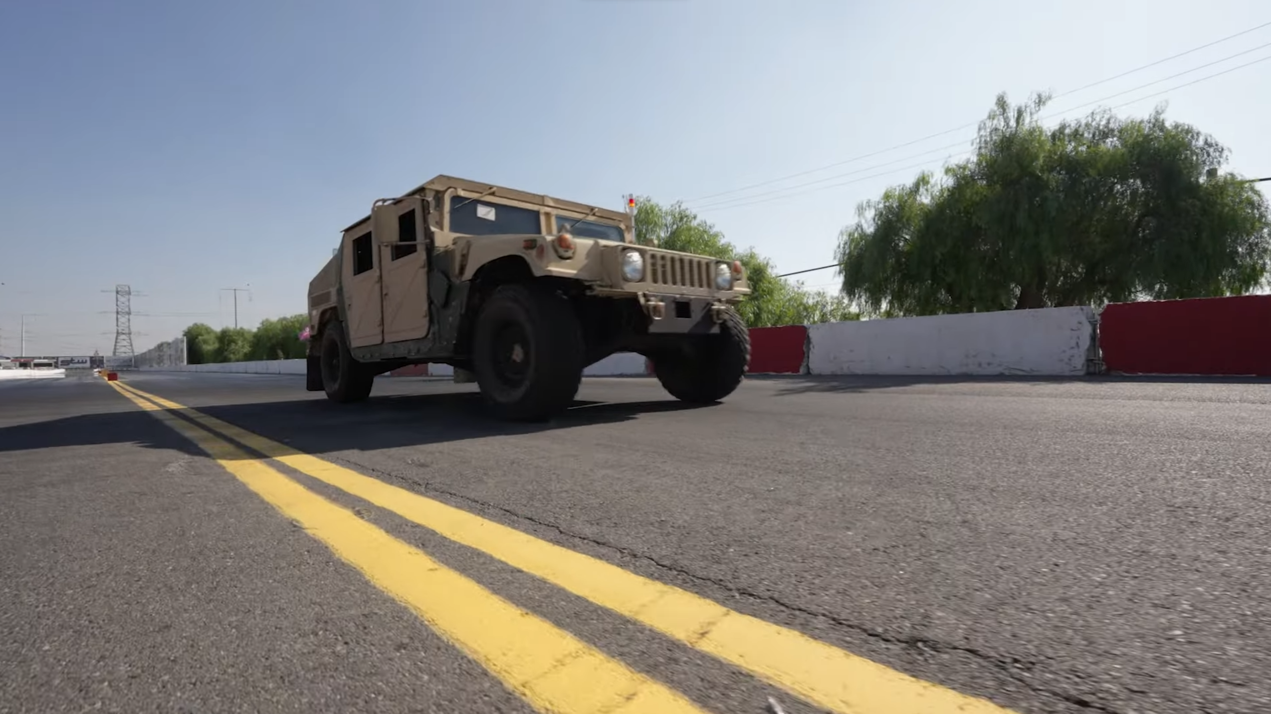

Why? The HMMWV spends most of its life idling so it won't benefit from dynamic braking in a hybrid drivetrain.
serpico760
747
1,881
San Diego, CA
If it's a hybrid then it won't need to idle because it'll have a battery pack that it refills from time to time. Regardless it's not like the military doesn't like to waste money either way! Anyway Banks is a legend ever since his over 200 mph Pontiac firebird back in the 80s!
87cr250r
1,345
2,103
Rodeo, Ca
If the pack gets depleted and it's time to go what do you prioritize? Recharging the pack or low performance skedaddling?

I seriously ask myself why!
We don't move the vehicles much after all. Even I use it as a dayli but don't get more than 20k miles a year.
So why deprive the truck of all its charging capacity? To install an unnecessarily complicated 12V system only to fail due to the fundamental ineffectiveness of the vehicle.
The HMMWV is not built to drive economically. That was never the goal! And there is no getting around this fact!
Not to mention the financial aspects.
Where is the break even point? What will it cost? In total.... Certainly not less than 10k, more like 15k. How much diesel can I buy with 15k?
No way! I understand that as an experimental approach. But certainly not as a serious offer.

I think it would be closer to 50-75K. maybe more.

Makes perfect sense “if” done properly. Same or more power/torque from a modern 3.0 di turbo even without electric help, compared to current derated engine. Nearly half the fuel consuming displacement at idle plus extended start/stop efficiency, and short “silent” operation with a decent battery pack. Theoretical up to 200kw of auxiliary power for electronics, or the freakin laser beams attached to your heads, not sure if enough for any worth while DEW though? And my bet is closer to $150k by time it’s retrofitted. Remember who the target market is…

What kills this concept is where Banks put the battery. It uses up the entire cargo area. Most EVs have the battery slung low in the middle of the vehicle between widely spaced frame rails. The HMMWV has narrow spaced frame rails so no huge battery will fit there.

If the target Market is the military market, i'm in. Mainly for the reasons you mentioned.
But in this case i hav to ask why to choose a outdated paltform!
And so we are back to a pure feasibility study or marketing stunt.

I'd like to be a fly on the wall the first time an 18 year old drops a wrench in the wrong place, or see a cargo hold full of them chain react as has happened recently.
