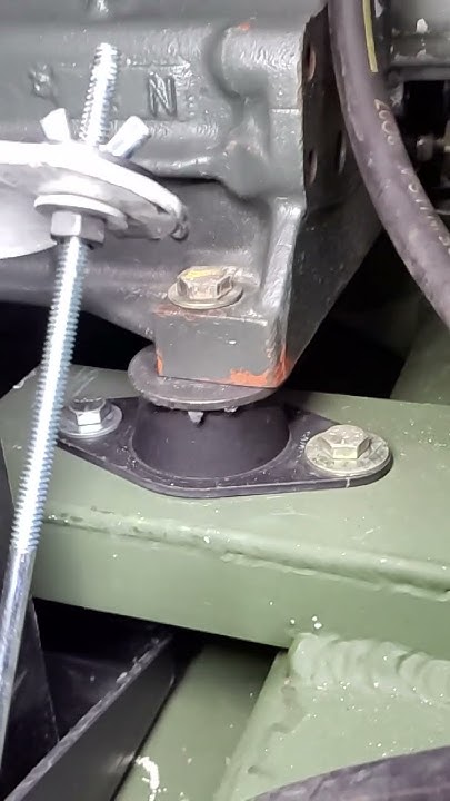

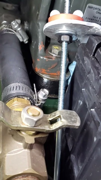

After starting reassembling and starting this unit up, I through a load on it. The unit was very shaky for a 802a, even after I tighten some loose isolator bolts. The unit could pull 6000 watts and seemed to be running fine, but anything over 3000 watts and the overload fault would trip after a minute or so. On the suggestion of a few members, I bought some Deoxit and hosed the S6 and S8 and exercised them thoroughly. I haven't retested it yet because the vibration issue really needs to be addressed. I fired up my other 802a for comparison and this one is much worse, so something is going on.
Since this unit had major oil pressure issues due to a stuck relief valve, I pulled the valve covers and inspected the push rods for bending per the TM. All looked good, so I reassembled the unit per the book procedure, waiting 90 minutes before hand turning the engine and restarting it. I also pulled the back cover of the genhead and look for a loose bearing. All looked good there. I also made sure the IPs were rotated to the same position, fully counterclockwise. It's worth mentioning that it seems to run good, pulls a full load, and the exhaust manifold is nice and dry with minimum soot buildup.
The front of the engine / genhead combo moves considerably more on its isolators then the rear. I've been thinking about what Guyfang has mentioned in several threads about the isolators, especially since the forward ones were missing hardware like someone had been messing with them. I'll look for part numbers tomorrow when the light is better, but here is some slow motion video of both. It doesn't look good.:ROFLMAO:
What do you all think?

Way too much motion.
That's an understatement. It makes my other 802a look like an 803a.
I will try swapping isolatators from another 802 to start with and hope that is the issue, otherwise it is likely the genhead and engine need to be separated.

There is one other possability. When you have the isolatators out, see if they have a part number on them. Check that against the -24P. If someone put MEP-803 isolatators in the set, that could be the problem. The 802A has a much stiffer isolatater.

Well, no luck here.
The paint shaker shows 88-21070-1 isolators, which crossreference correctly with-24P part number (88-21070-3)
My 803a uses 88-21070-2 isolators. The -24P calls out 88-21070-4, which I can't cross-reference, but the convention follows similar to the 802 isolators.

Looking at the wear pattern in the skid base and broken weld in the left battery area, this unit has been shaking hard for a long time.
