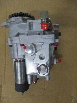

Is this the whole thing for $1000 (CAT 223-2254) Mechanical Unit Injector tools
I don't need another article 15 in SS but I seen the whole rebuilt unit for $1000 on eBay
The injectors on the 3116 engines in A0 trucks are mechanical. They have a complex rack system to actuate the injectors, that needs to be carefully set up and calibrated. There is a tool set that facilitates that calibration procedure, or at least makes it easier, and it's expensive.
