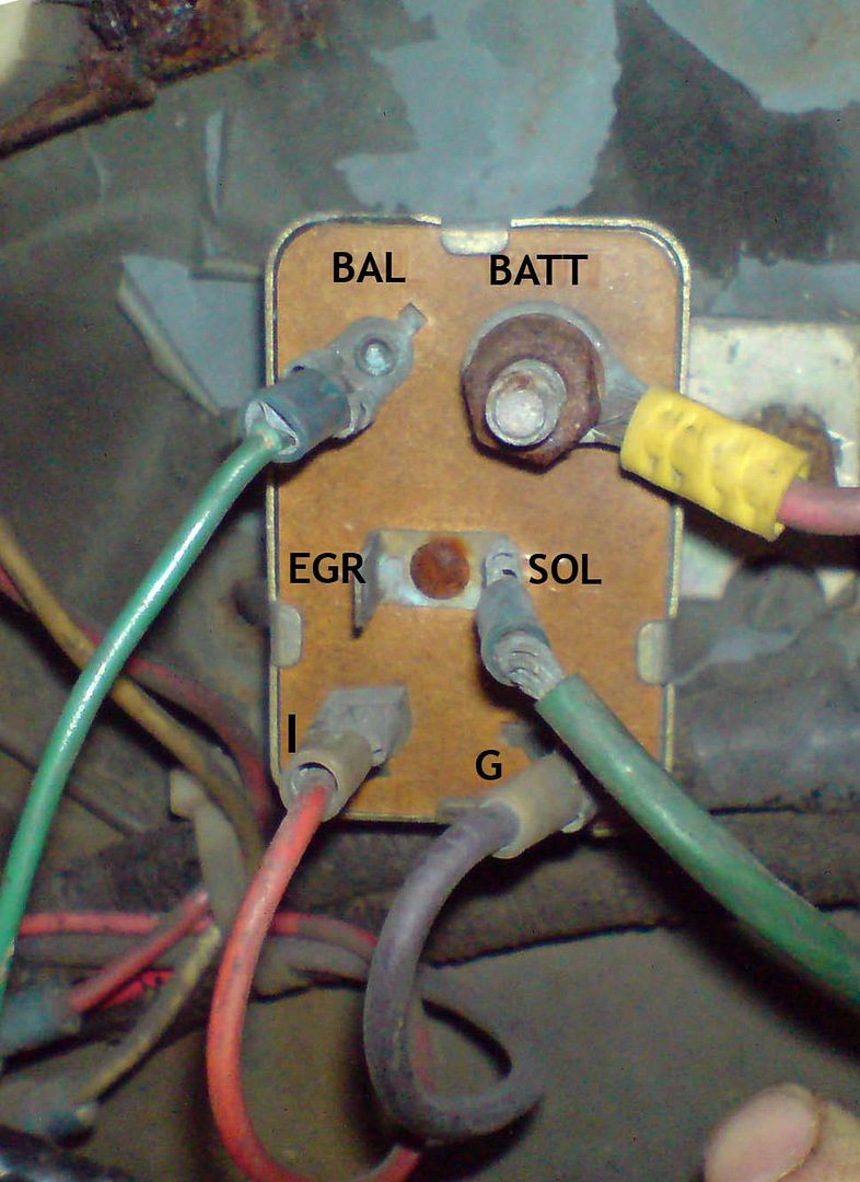

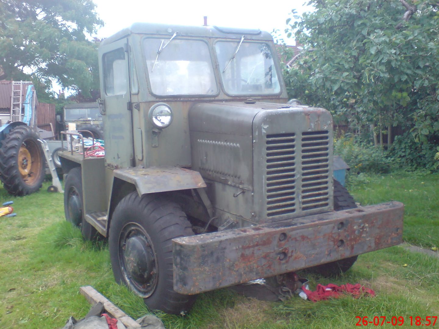

I'm more at home messing about with old British cars but my brother in law has just bought a Coleman G40-F Aircraft Tug and we need a little help putting the ignition system back together because someone has removed the ignition switch and unwired a few parts of the dash.
This is what it looks like: It's got a Chrysler (440 we think) short block V8 engine and in some spare time yesterday I identified hopefully all the parts of the ignition system, the following photos should help:
Starter Relay

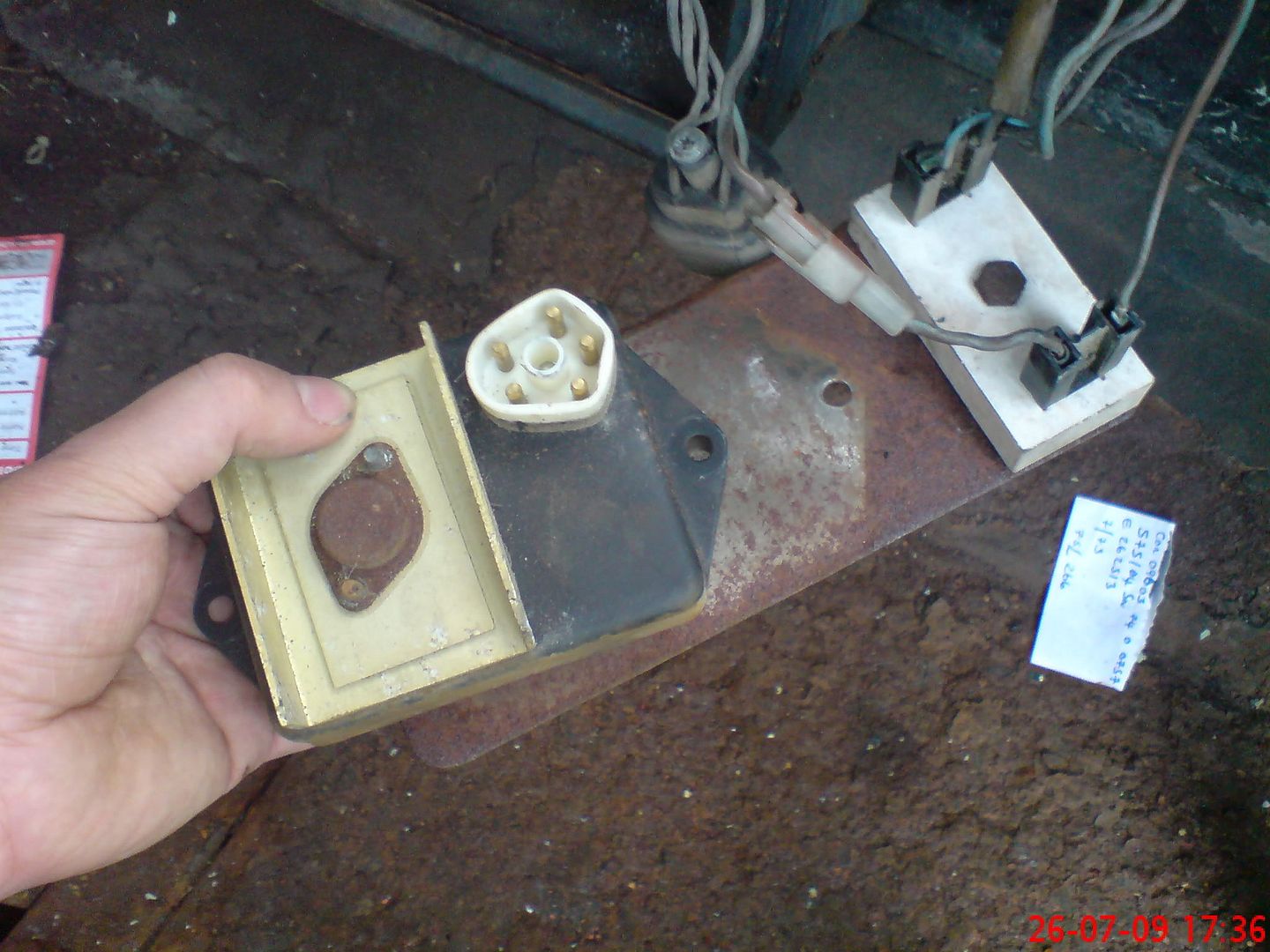

Ignition Control Module and Balast Resisters

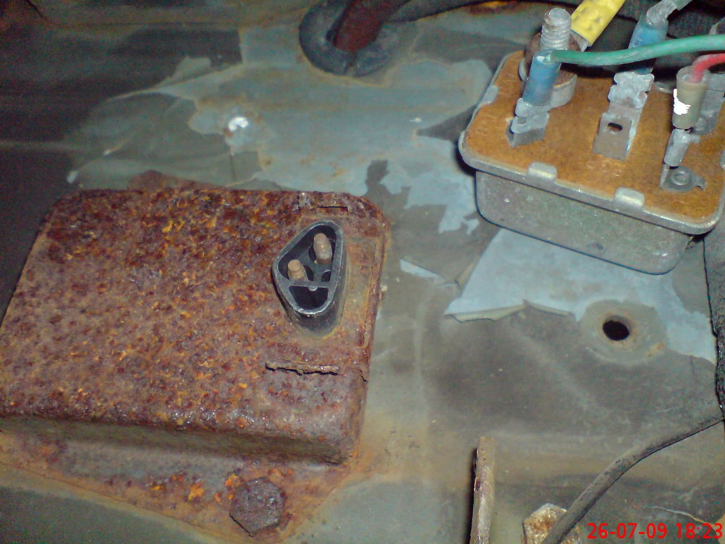

Rusty Thing on Bulkhead (on the Left)

The connections to the Starter Relay are as follows:
BAL: Two wires - one to the side of the coil and one through the bulkhead, disconnected in the dash - see below
BAT: Connected to the +ve terminal on the starter motor, same one as the battery
EGR: No connection
SOL: Connected to Starter Motor Solenoid
I: Wire goes through Bulkhead and is not connected
G: Connected to ground.

The two Balast Resistors are 5.5 Ohms and 1.4 Ohms.
Everything else seems to be wired and untampered with, including the mysterious Chrysler Igniton Control Module that I uncovered more information about here, scroll about 2 thirds down.

are those the same wheels used on a goat?
how much does it weigh?
is it four wheel drive? four wheel steer?

Welcome to the site. All of those parts pictured are conventional 1970's Chrysler ignition parts, the rusty thing is the regulator for the alternator. Same parts as the M880, which is a 1976 or 1977 Dodge W-200 pickup truck. You can obtain these parts anywhere. As far as a schematic, I cannot offer assistance, but you should be able to trace everything out and get her running.
BFR, the wheels are 20" and Coleman specific.

To answer your questions: I think it weighs around 7 tonnes, certainly more than 5. It's got an auto gearbox and I think it's 4 wheel drive. It's certainly 4 wheel steer.
