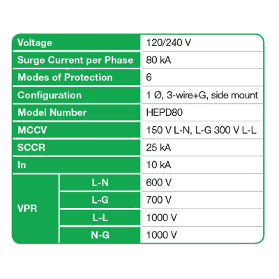

The one you went with appears to be rated for 45 kAmps, whereas the Square D is rated for 80 kAmps. What makes your choice better?

That's a really good question. When you are looking at a surge rating there are a couple of numbers to consider together. One is the Surge Current Per Phase. On that one the Square-D looks good at 80kA where the Eaton is a little lower at 50kA (the Ultra is rated at 50kA where the MAX is 45kA). The second number to consider is the SCCR which is the total amount of (short circuit) energy the unit can handle. The Square-D here is spec'd to handle 25kA. To me this says that the true limit of the device regardless of the single phase current rating is 25kA. The Eaton on the other hand is spec'd to handle a SCCA of 200kA. That is a benefit especially if you are getting a surge on multiple lines at the same time which is most certainly going to be the case.

Edit - Both provide protection across all lines and multiple modes (current paths). That goes into the plus column for both.
