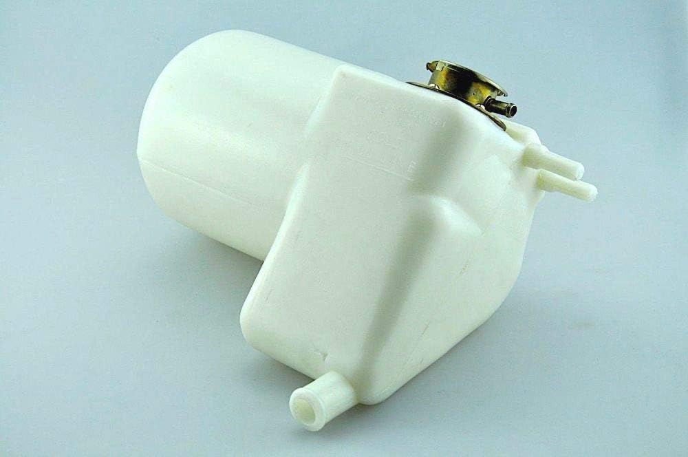

So, I was trying to release my old, stuck radiator cap and I must have cracked the riveted seal on the neck of the tank. I replaced the cap with a new one and it started leaking at the rivets. So, I ordered a new, plastic tank and sealed the old tank with epoxy to get me by. The new tank came in and I swapped it out but I still had a small leak. It seemed to be leaking at the top hose. I trimmed down the hose (plenty of slack at the top small hose) and refitted tightly. It stopped leaking there but then it started leaking in a new crack on the side of the tank, above the main hose connection!
I now ordered a new one and tried to seal it with epoxy (removed the tank, dried it, sanded it, etc.) but the leak went right through the epoxy! There must be tons of pressure to cause a leak like that.
Anyway, is this a common problem? The original one lasted 20 years and the new one only lasted a month so I'm reluctant to trust another plastic tank at this point.
Anyone have experience with MME's aluminum tanks?

Watch out for cheap imported tanks. Usually they are a white ish plastic. OEM have a light brown - mustard color. Make sure the hoses have slack as to not transmit engine vibrations to the tank fittings.

If you spent less than about $250 on the expansion tank, there is a 99% chance it was a chinese import, and those are known to have major issues.
Mine was cracked when I bought my truck (with only 32 miles on it) and at the time an OEM tank was about the same price as an aftermarket aluminum tank.
I seriously recommend the aluminum tank, the only thing about installing mine was I had to move the air conditioning hose a little (system wasn't charged yet so not an issue) by loosening it at the compressor, as the aluminum tank was slightly (less than 1/4") longer than the OEM tank.

Ok ...Back to tell the story. Ready?
I too have had overflow tank issues. Being the guy that says "if it ain't broke don't fix it" or this time have some cash to throw at Mr. Humv so bought one of those new style overflow tanks. You see them all over for about a 100 bucks. Out of the box... looked real nice, bright and white, not like the old dingy faded yellowish old one and it bolted right up.
A year goes by and I can smell the hot stench of antifreeze. It doesn't take much and hound dog nose is going nuts and as typical can't find the leak. So look, feel, sniff and the old tighten the clamp for the heck of it. Weeks go by and still sniffing and a stinking on and off. This is a bit worry some as I can usually get right to problems. Well, lucky this old dog... truck wizzed on the driveway. GOT YA NOW.
Tracked it down to you guess it... the almost new tank. After removal... old dog was a barking mad. Two inch crack right thru the white plastic.taank2.jpg and a close up between the black markertank4.jpg
Not the hot glue or JB weld guy so the search was on for new and R&R ASAP. Found one from well respected parts supplier Walkers., $68. Thanks Dave.
Had it in hand two days later and now comes the real story.
Side by side something wasn't right. Color of mil spec one was that faded yellow. Who cares about color? So in it goes. Perfect fit,
SO today with nothing to do.... the help of non-destructive tester "86humv' and my big hammer and sawzall, we discovered the following:
Different colors. Hammer test showed white plastic was tough. Didn't bang on the new one, in service.
Slightly different in the molds, noticeably forward lip around the filler neck. The old white one has a thinner steel filler tested with magnet with bright yellow zinc plating (brass like look). Mil spec. Heavy brass. The real deal.
tank5.jpgCheap ass steel with worn lip at cap seal showing rusty steel... DAMM ! (screws missing for test)
tank screws.jpgScrews holding filler to white tank, cheeze funky metric, sloppy pitch, low grade stainless. Mil spec tank 6-32.
Sawzall reveled additional deep and long cracks inside almost to the surface near lower outlet. Tank never was frozen to burst or swell.
tank crack.jpg This looks a little weird. Photo of inside tank showing another crack in the making ... Errr cracks. Brown lines LOL.
Just read this in another thread "and if you don't mind cheap chinesium parts" I DO, buyers beware.
It's something to add to your HumV knowldge notes. The easy magnet test to the filler, points to the IMO knock off tank.
Last photo clearly shows a bum tank, CAMO

A quick search of American Custom Molding turns up nothing?? American Custom Rotomolding... looks on line to be a real quality company. Employee reviews, not so good. It is the internet, Soooooo. Thanks for the numbers 86humv.
Close up view of the Amazon product linked above is a spitting image of the one that failed AND note NOT an USA / America / Red white & blue product.
Keyword in ad " Non-Domestic Product " Could / should be a clue. Looks exactly like the the one that failed. If it comes with a cheesie cap, another clue. Other popular sites looked the same IMO.
The magnet test of the filler inlet is the definitive test. If it sticks, It sucks.

So somehow the TACOM brand can make and sell them at 1/3 the cost of any other U.S. manufacturer/seller?
I checked the Amazon listing for the tank.
First it says "Country/Region of Manufacture: United States"
Then later is states "Non-Domestic Product: Yes"
So it's a U.S. made product that isn't a domestic product....
To further compare the two, the OEM tanks are NOT pure white. They are more of a beige color. They also have a visible diagonal seam.
Picture below taken from https://genuinehumveeparts.com/product/12340061surge-tank-assembly It clearly shows the color, the seam, and the design of the flares on the hose nipples.
SURGE TANK ASSEMBLY
Below is the TACOM tank. Obviously different plastic color, different mold design, no flare on the hose nipples. No way is this an OEM tank.
Here is one from the alibaba website. Notice anything similar?
So to go back to rule number one of buying stuff off the internet: If it seems too good to be true, it usually is"

UPDATE!!!
I put an overnight rush on the plastic tank replacement (from SECO, who initially sold me the one that failed last month) and the custom aluminum one from MME.
The new replacement from SECO arrived sealed in the original bag inside the sealed box. This box was the exact dimensions of the tank, indicating this was prepared and sealed from the manufacturer.
Are you ready for this?
On the bottom of the box was a small gold sticker that read "Made in Taiwan."
Mystery solved.
I elected to set aside the $115 paperweight and install the aluminum tank. Done deal.

For the record, these parts (none of them) were purchased on eBay. In fact, I don't order anything point n click. If the vendor doesn't have a phone number with a human on the other end willing to accept my CC info via phone, I shop elsewhere.
Here are the pics of the tank. Both the original and this one were purchased at SECO. I am not at all pointing fingers at SECO for selling defective parts intentionally. I'm just pointing out the details of the parts I received and my experience thus far.
