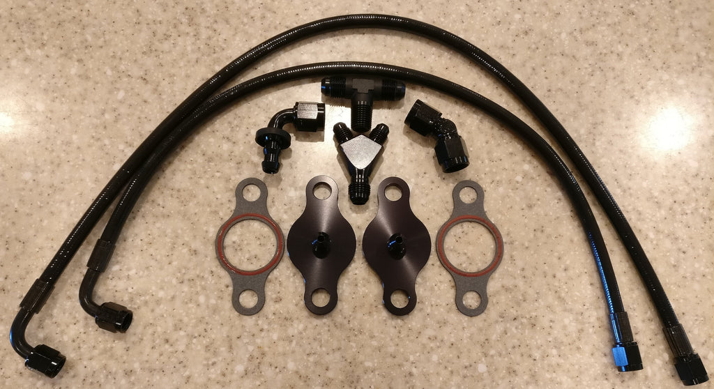

I upgraded the cooling fan
kit got temps down to 190-210. Question is should I also add on the paradox cooling kit.

Yea I have this same fan, for me it's much better than the original cadillac valve setup, especially going uphill. I know people say these engines can run hot, but these 6.5s are not no cummins or duramax, the 6.5s are well known for a high failure rate of overheating and crack blocks. I also feel a bit more comfortable with my engine staying in a more optimal temp range, instead constantly heating up to 230 and cooling back down to 180 every few minutes or so. As for the paradox cooling kit, I don't think its 100% necessary, I have it, but I never tested it or seen anyone else test it to actually see if it cools the rear cylinders better or possibly even create more hotspots in the engine.
In my opinion, just the fact of not having to worry about the fan leaking makes it worth it.

I took off a perfectly functioning hydraulic fan clutch and installed a viscus clutch some time ago,
Why? although it is true that the hyd system locks up 100 % and the viscus system only 80% the viscus system unlocks to 20% instead of 0% so there is always air flowing. It gets hot here not uncommon to see 104 to 108 deg for months on end and I didn't like the engine hitting 220 to 230 the fan kicks on and cools it down to 180 to 190 then back up to 230 over and over again all day long. Now with the viscus clutch my temp gauge sits right at 190 all day in 104 temps (using the factory temp gauge).
So I like the viscus system, Don't Know that I needed it but I like it. I also run the paradox system, don't know if it helps but I feel that anything that helps trapped air or steam out of the back of the engine can't be a bad thing.
