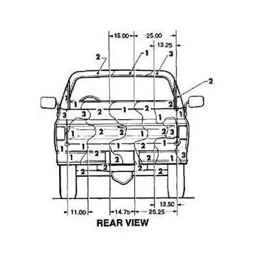

I know this thread is as old as the hills - but a question, none-the-less. Can I just rattle can the black and brown after a complete green air compressor/paint gun job. If yes - it looks like the camo wasn’t “taped off” except maybe something between the black and brown.
I’ll give it a hard looking at after I spray all green, but think the original style camo give it a little more.

Just assume that CARC paint was originally applied. So wear a respirator and keep all paint dust out of eyes and off your skin.
When we painted vehicles there was an Army publication that showed what colors went where and how to place markings and the dimensions the markings should be. We would chalk outline the colors and number each patch 1, 2, 3, and so on. Then the different cam pattern colors were sprayed on - just like “paint by #’s”. If there was a little overspray it wasn’t a big deal.

I advise against the chalk lines. I done this one time and I had chalk lines show thru on the edges. If over spray don't matter use a picture and do your best. I painted many things and only did the chalk 1 time with less than favorable results. Not my truck, do as you wish. Have a Great Day.

As Cucvrus said, chalk shows through the paint.
I have had good luck making small pencil marks at key points of the pattern, don't have any problem with them showing through. I've never tried outlining the whole pattern in pencil, I may have to experiment with that.
A friend did the same trick, but used a magic marker of some sort instead of a pencil- the ink apparently reacted with the paint and bled through to the surface. So you probably shouldn't use those!

Pencil lead on the surface will repel paint. Anything on a top coat is going to interfere with the adhesion and finished results. On a combat vehicle that is still being used tactically it will not matter. On a private owned vehicle I would not like it. I try my best. It is wet on wet. I spray the entire vehicle green and them move on right away to the brown and right after that to the finish of black. I use pictures and a great Wife to point and direct during the camouflage pattern. If it is close and has nice smooth edges it is the look and quality that is needed. Old CARC used to be a PITA and get dry edges everywhere. The best thinner to use was MAK. I used MEK and it dried before it adhered. But with the rattle cans you can do a decent job but same as anything else. 99% of the job is the preparation and without proper preparation you are wasting your time. Over sprayed rubbers, glass and lights are what I see a lot on camouflage paint jobs. Good Luck. Do it right.

Not trying to argue; but I will say that I helped paint an entire Mechanized Infantry Battalions vehicles in woodland camo. Not a single chalk line was visible.

It is incredibly OLD FASHIONED but the old overhead projector - something like was used in grade school - is a good way to push the outlines to the truck. The TM that shows you how to paint the shapes with a projector makes the job simple.

You misunderstood. We traced the camo pattern out in chalk then numbered each pattern 1, 2, or 3. Then we sprayed the chalked pattern with whatever color the number called for. So we were spraying over the chalk.
