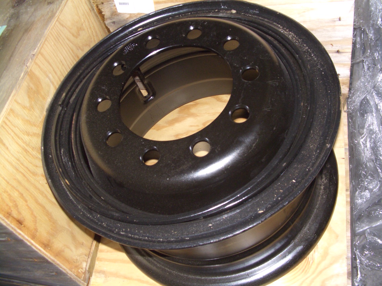

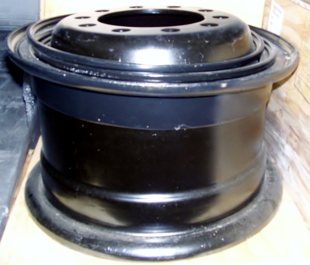

So I got a 79 M52A1 and I LOVE IT ( my 1st born) It came with stock 11.00 20s on stock rims. They were not wide enough in the front & I kept sinking in front but could almost always back out with the 8 1100s out back locked up. So I found a great deal on 6 395/85R20s Goodyrs on HEMTT rims and I Love um BUT 8 of them out back is my new twisted dream without it looking ridiculous. This is my thought on how to do it without breaking the bank. I was thinking I could use the centers from the dually rims to replace centers on the HEMTT rims and do away with stock rear springs and put 2 sets of front spring packs under the frame to gain some room. I dont know if theres a easier way, flip hubs, spacers, different rims but I would love to hear some ideas on what the pros think. I want to keep that stock dually look just bigger. I do NOT want the outside tires sticking out past the flatbed more than a few in. tops. Please help me make my dreams a reality.
Some Pics for your viewing pleasure

Didn't some of the bridge trucks have wider dually tires in the rear? I know they were way outside the width you want but I think they used spacers and maybe their wheels without the spacers? I'm just shooting in the dark here as I don't really know much about the bridge trucks but maybe something like that would work.

Theres a Lot of CNC guys around here in S. FL making custom rims for 2.5 n 5 ton mud trucks & the prices have got fairly reasonable. I was thinking they could make a The rim I want out of the 2 types of rims I have & am looking for a way that has worked in the real world. I think those deep dish rims are gonna be hangin way out there. Does anyone know the dimensions of the bridge truck rims, do they clear in the back without a spacer, longer studs.....

Okay I have looked hard at doing this and staying legal and the best thing I have figured out is mount the inside wheels to the axles then a spacer or a modified wheel to the outside. This way you can simply remove the outside wheels for travel on the road and when you get to where you are going add the outside set.

The picture of the dual gap wouldn't upload. The inside rears are the same as the front, and the outer is re-centered with a piece of pipe. You might get away with a FMTV wheel inboard and a bridge truck wheel outboard.
