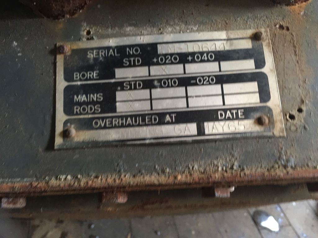

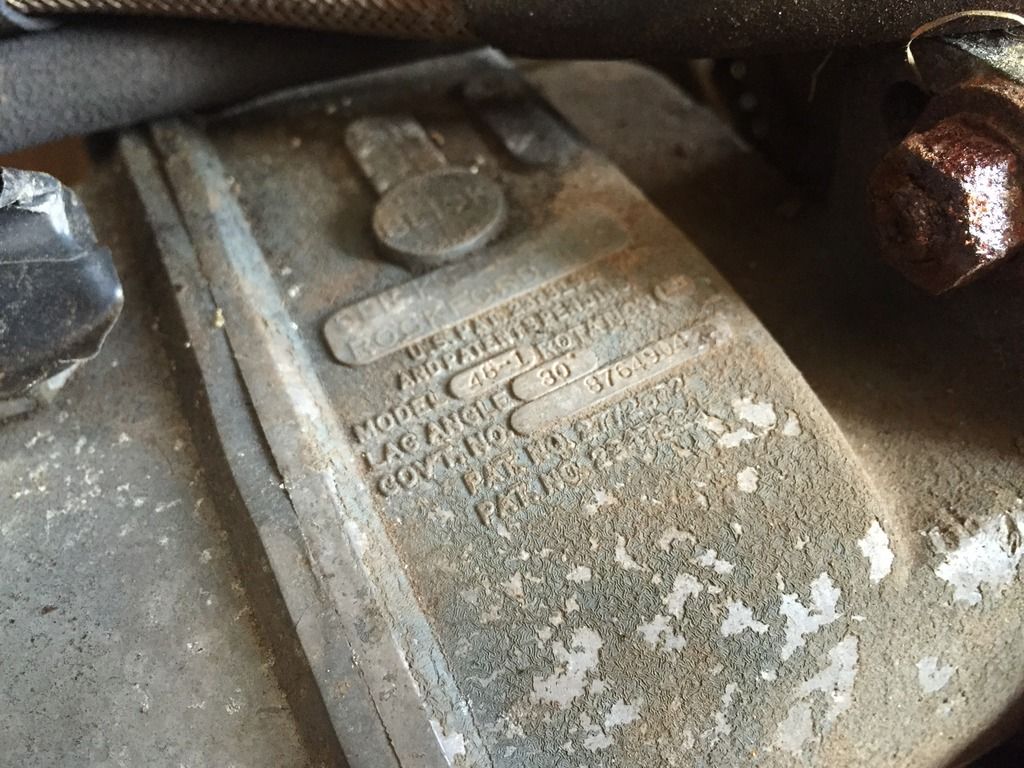

Well spent almost another 5 hours there today. Man that mule is rough!! It has the A1 ID tags on the bed but it seems the rear wheels are not able to turn like an A5. After an hour of looking we found the 4cyl air cooled motor, as we rolled it around water was coming out it the crank case and valve cover breathers. So, Ummm, I'm going to assume it's compleetley junk.
The he bed has the 6" hole or what ever for the heavy gun mount and where the seat bolts to parts have been ripped off. I haven't seen a seat for it either.
Mai was going to tell the guy no more than $500 since it's such a basket case. Is an A1 with 4cyl "worth" more or less?
i did not get pics of it, I'm sorry, spent too much time bouncing around the place.
Motor pics though.

The 4cyl mule engine is unique to itself. The 2cyl military standard engine can be used in the mule, however you will need a 2cyl mule engine as a parts donor as a lot of the exterior parts are unique to the mule application.
