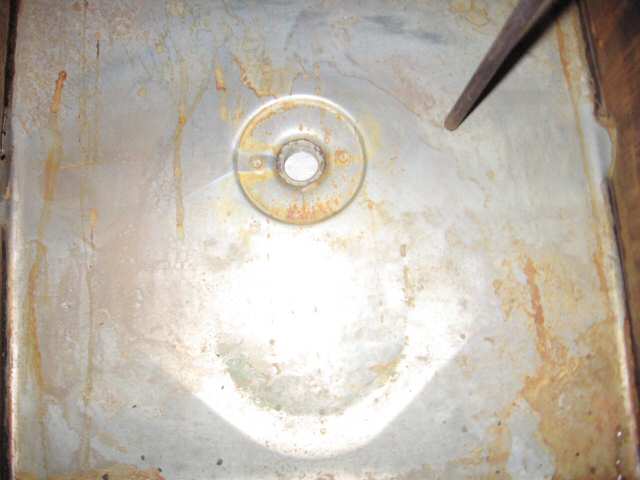

Best way to clean out a fuel tank is with hydrochloric acid (muriatic, pool acid)... Takes 1 or 2 gallons pending how bad the tank is. Dilute the acid about 25% with water and slosh the tank around every 5 minutes or so. Usually will take about 30 minutes to do, an hour if suborn... When you are done, rinse pour in a box of sodium bicarbonate (baking soda) with a little water, then rinse again...
If you have any sodder joints on the bottom of the tank (drain plugs, etc) do a quick pressure check with soapy water before reinstalling.
Pic below is of my Deuce tank... I WISH I would have taken a before shot, it was horrid!

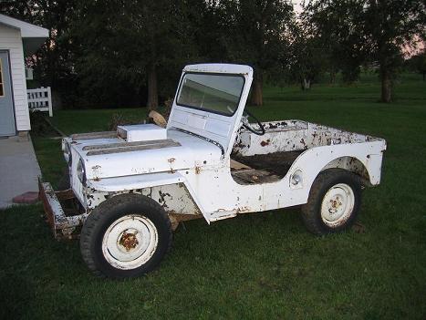

I finally took a picture of this beast. One other question...I have a straight pipe out the exhaust manifold. It ends under the floorboards. I also have a flowmaster. I am not sure about putting it on the jeep, but all I would have to pay for is installation. Any ideas? Oh, also, any ideas on seats? I can't afford to spend $600 for frames and cushions. Thanks!
