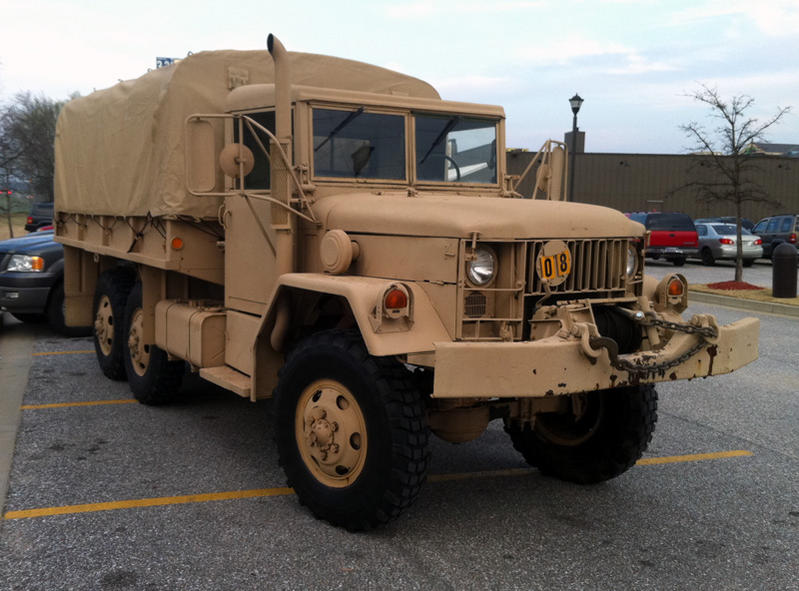

Wow Hank, that's a great looking truck. I am glad you made it home safe and sound.
MWMULES
5,580
345
DESOTO, KANSAS

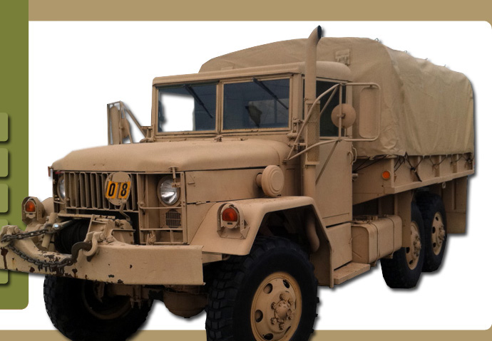

Hank just watched your cold start vid and it doesn't seem like your low air alarm buzzer is working. Or at least I did not hear it when you moved the Ass switch to on. That is something that needs fixed no matter how bad it sounds.
YouTube - HanksDeuce's Channel
91W350
4,414
57
Salina, Kansas
Sounds good!! That is a really nice looking truck. I watched the videos earlier on the phone and could not make out the air gauge, my deuce's air alarm seldom goes off if I drive it every couple of days, it will not normally bleed down under 75 pounds overnight. I had to wait to post until I could watch on my computer though, I agree, you will want to fix that alarm. Looks good, sounds good, I hope it stays good! Nice truck, Glen
m16ty
9,576
211
Dickson,TN
On the video where you are showing the gauges going down the road, the oil pressure does seem lower than mine. Check and make sure you have a 60psi sender and not a 120psi sender. If you are running a 120psi sender the 60psi gauge will read 30psi when it's actually 60psi.
Looks like you've got electric wipers. The gauge arrangement is odd also (gasser cab?). What year is the truck?
ryker725
258
Luling, La.
Great looking truck Hank... Nice talking to you on the phone the other day. Did you get the answers to the WMO questions you had?

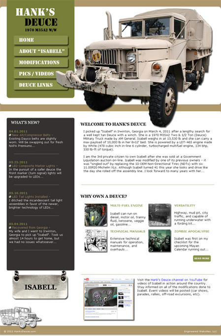

I finished the website for my Deuce - Isabell.
HanksDeuce.com
Check it out and let me know what you think!
-My driver side tires are on backwards
-warning, I bought chocks from Harbor Freight
-only 2-3 iPhone pictures, the rest are $$$ Digital Camera
-my winch cable needs to be spooled a little better
Be Nice! I'm a newbie dammit.

Nice website.
Your truck's pic on the homepage is reversed.
H
Hank.
Guest
Yep, I rushed that top right picture because it was raining outside and I couldn't snap a better picture. Good catch. I just updated the site with a better picture. It seems between both of my digital cameras Isabell has 2 different colors. :cookoo:
