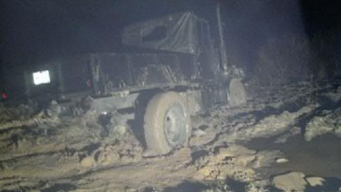

Help plz stuck in byron
bill2444
272
cheboygan/mi
When pulling with you friends deuce, remember that they pull a heck of a lot more from the rear: than from the front.
Sorry that's I have to offer for help...
axlr8
424
Rushford MN
Also, if you have big snatch blocks and 2 anchor points rearward of the truck, you could probably get some nice leverage depending on what you set up. But no normal snatch is that big.
bill2444
272
cheboygan/mi
If worse comes to worse, and you can let the truck sit for a few days, I have 200' of 5/8" cable&hook off of my 5 ton winch I got that you could have( ups is on you though) Then you could utilize the self recovery method. An offroad recovery by a big truck towing company will leave you crying for months($$$$)
wreckerman893
Possum Connoisseur
15,644
2,127
You have two problems....the front axle is high sided by the mud so the tires have little or no traction, then you have the resistance of the mud that the truck is stuck in to overcome.
You are either going to need brute force to overcome both problems such as a big tractor or dozer or you are going to have to get enough mechanical advantage to pull it out with the other deuce.
The other duece needs to have a load on it for maximum traction and to supply mass. You need to avoid getting that deuce stuck as well. If you can get a load on the recovery truck get as close to the stuck truck as possible and hook to to.....if the recovery truck has traction it should be able to pull it out using a tow chain, cable or snatch strap. Pulling in reverse in Low Range will give you the max advantage.
To get mechanical advantage you will need some steel cable and snatch blocks and an anchor point if the recovery vehicle doesn't have a winch.
There is a TM that tells how to rig MV's to pull them out but I forget the number......don't know it it has been posted here.
Since you are in a power line right of way there are prob not going to be any solid anchor points to hook to.
Hope this helps.

think the op is unstuck, at least that is what post #33 sounds like

I'd like to know what you were snatching it with. You can do amazing things with a 60,000# strap and another deuce. Ask Ferro
