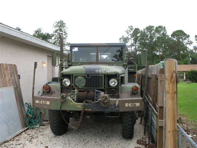

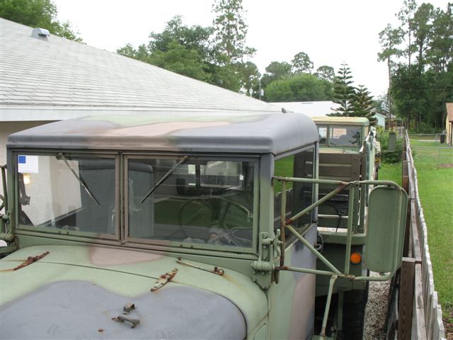

She's finally home. Yesterday, I got a chance to drive her home from lavarok's place with Ian following in the M1009. She drives very nice and made the 40+ miles with no issues.
On another note, I'm 99% sure I found the author of the note on linkedin. I sent him a message on there, but I haven't received a response yet.
Here are a couple of shots of her at her new home.
