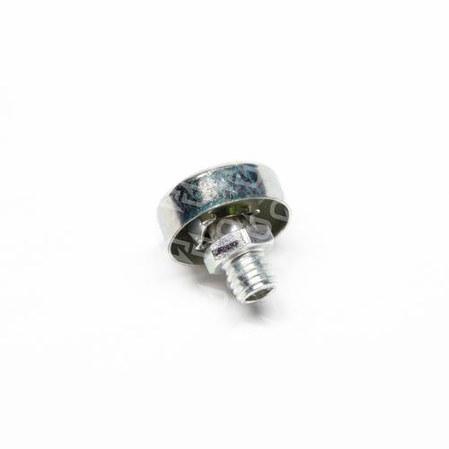

There is a little air cap/vent on top of the trans housing. If water got that high, the trans probably has water in it. Do not roll over the engine or trans until you confirm no water in their oil. Water kills the clutch plates. First check the dipsticks for excessive level, then drain the sumps.

The transmission body has a breather that is located more or less right below the PPD/LBCD behind the spare tire carrier. It's easiest to access with the spare tire lowered. It is NOT extended to the height of the front hub/axle and bell-housing breathers since it's screwed directly into the transmission and doesn't have an extension hose.
The bell-housing breather is behind the cab zip tied to the spare tire frame. Typically the fording plug is not installed unless you are going into high water. But maybe you got lucky and it was already plugged.

no, the bell housing vent is a hose up alongside the arch that supports the cab latch. There is a small round metal cap breather/vent screwed into the top of the main transmission case, about 18" aft of the bellhousing/cab arch. It is only marginally higher than the top of the upper chassis frame rail
General showed a picture of it unscrewed from the transmission case in the previous post. As he said, it is easiest accessed in between the spare tire and airfilter. I will shoot a pic of its installed position when i get home as mine is out in the open and easy to access. If the water got up above the frame rails/to the top of the bellhousing, that vent was underwater and could admit water directly into the main gearbox...

OK, I think I found the right one. It IS installed... So I should be OK then? I would really prefer not to have to drain the new transmission fluid if I don't have to... The water was probably over it for about 12-24hrs...
GeneralDisorder
2,455
5,984
Portland, OR
NO! It's NOT a plug. It's an open breather port. If the water was over that point then the transmission is likely FULL of water.
That vent is where the transmission will puke out oil if it is overfilled.
You will likely ruin the transmission if you even start the engine with it full of water. The pump runs anytime the engine is running.
