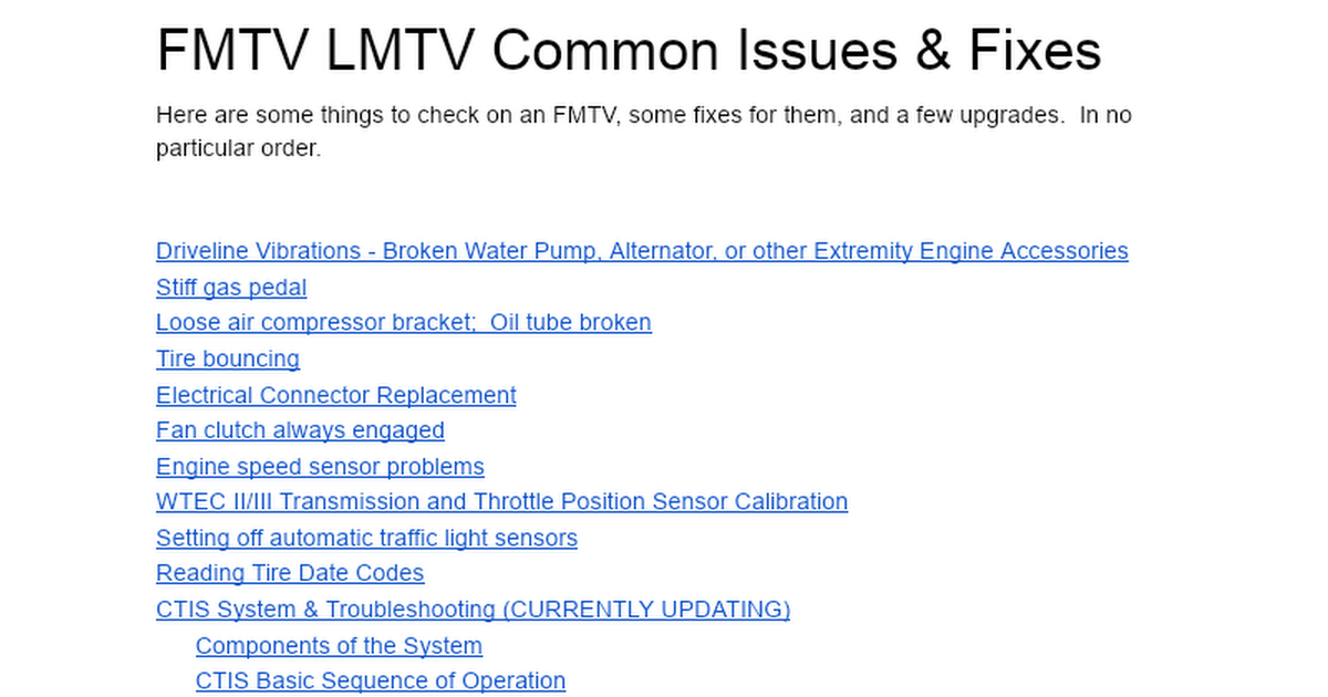

There is another source of information - written in regular english - that might also help.
Search for "Air / Hydraulic Unit Repair"
