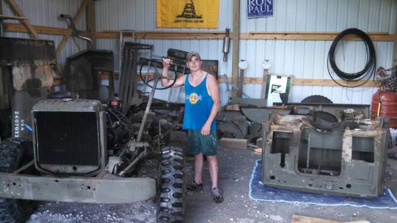

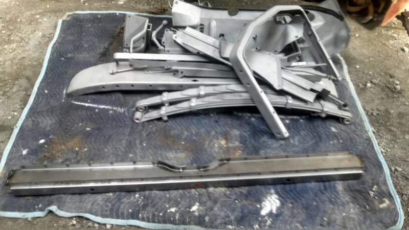

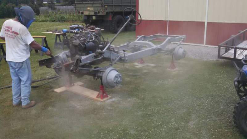

Kyle has the cab bolts off, we are going to call the sandblaster. Then we install the new leaf springs, shocks, break lines, master cylinder, wheel seals, do a bearing check, new pinion seals, and break drum & wheel cylinder job.

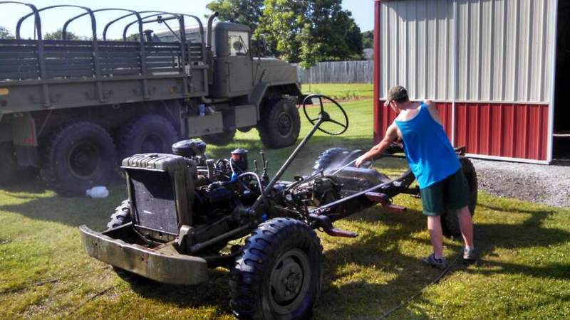

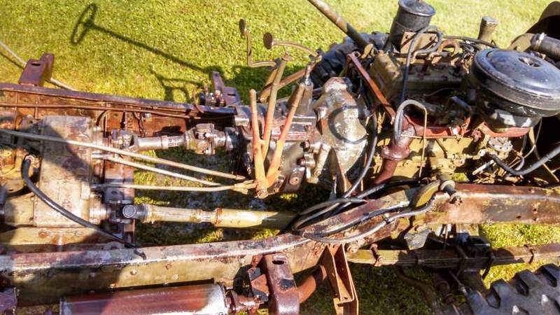

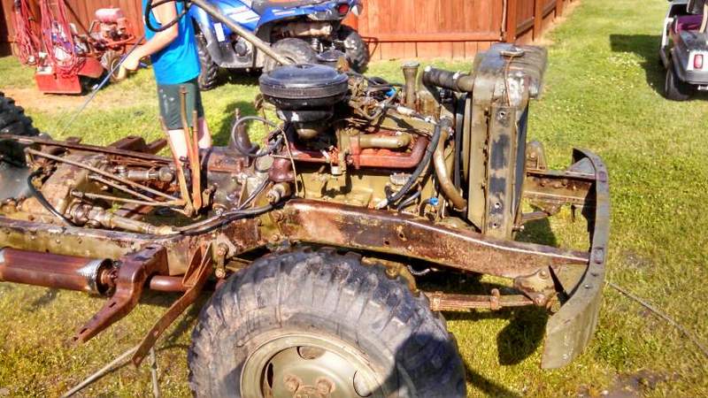

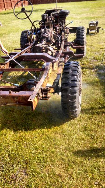

Removed all of the wiring, the cab, sprayed clean, applied zed industrial, waited 5 minutes and pressure cleaned again. The Zep worked great, I applied it undiluted which removed most of the old paint.
Working with Kyle (a teenager)is a lot like training a puppy, he doesn't know anything, he doesn't listen very well, but he's full of energy and eager to help.

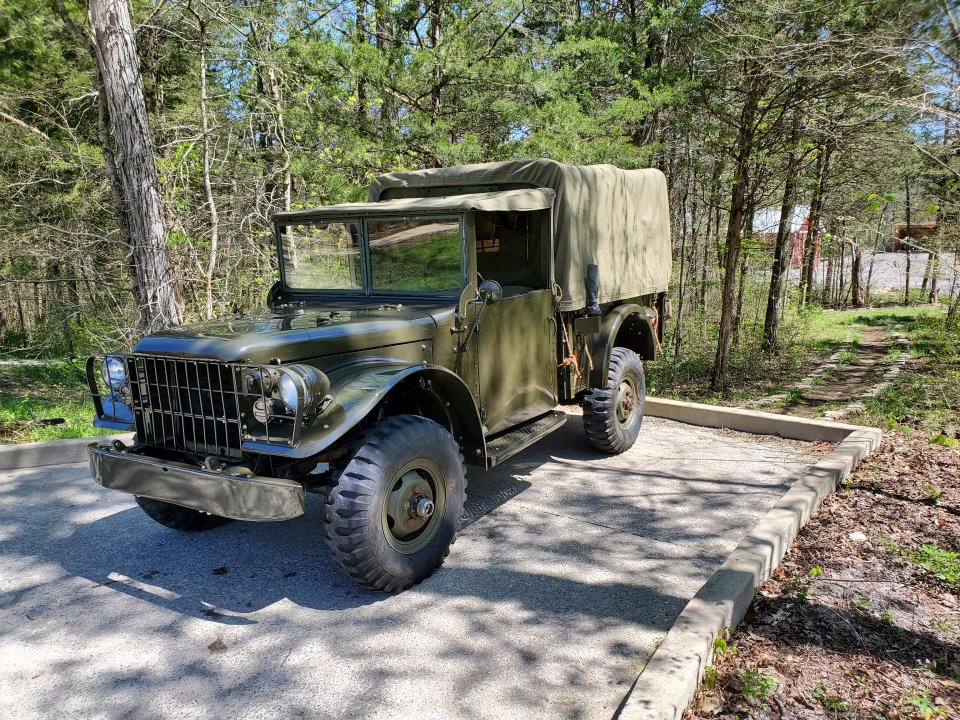

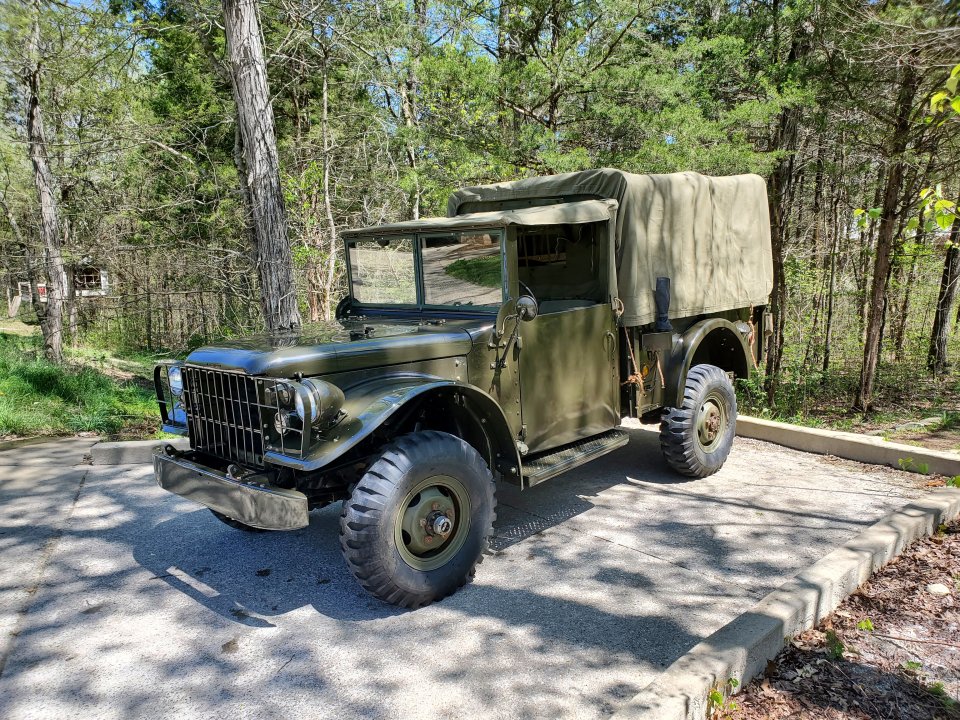

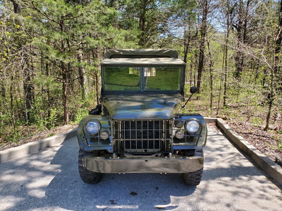

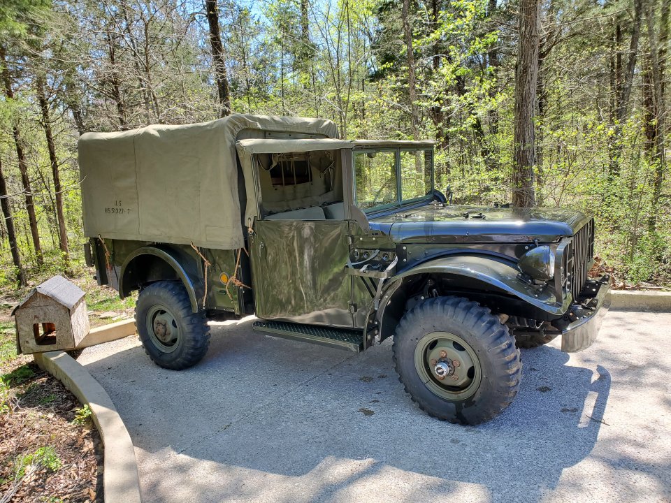

Got the truck re assembled and running. Gave her a quick wash this morning. The kids mine any my neighbors love riding in the back.
I have a parasitic draw isolated to the generator or regulator. Gonna need some help with electrical, it's not intended wheel house. I've been looking for the test adaptors for the generator and regulator but can't find them. It's the only way I can follow the manual for testing the battery drain. For now I just un plug ground when I park it.
