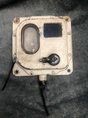

Some folks add an armor light. They are common on ebay

Very nice, just ordered two of the armor dome light units, any idea what bulb type they use so I can order led equivalent?
