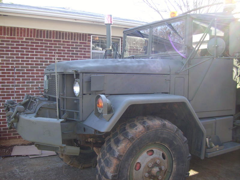

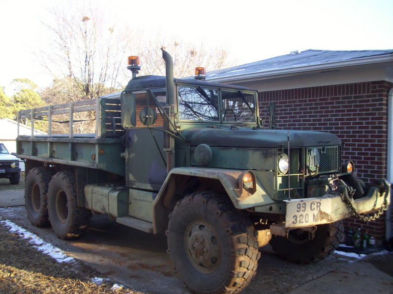

Today my Deuce went green. I guess its trendy now or something.
I used Krylon Camo Colors (12 cans of it so far, OD) and it went on fairly easily. Looks more like the WW2 OD than 383 but it suits the truck fine. Hopefully it holds up. I ran out of paint and my finger is tired so I still have to paint the rims and troop/cargo racks in the bed. The interior paint was pretty new looking with no flakes/rust so I'm not messing with it.
The first picture is a before and the other 3 are after shots.
