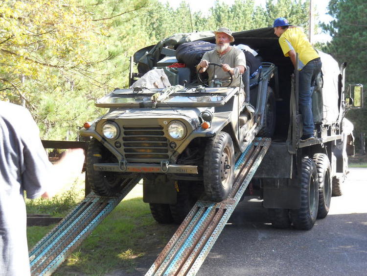

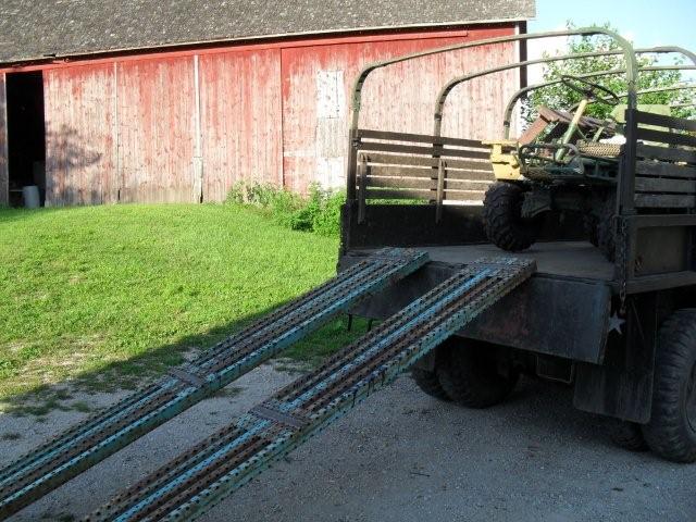

Well after looking for some light weight ramps on CL. to use to load my jeep or Mule in back of my deuce. I gave up finding any thing long enough ,so not to be to much incline and strong enough to support me and the jeep..

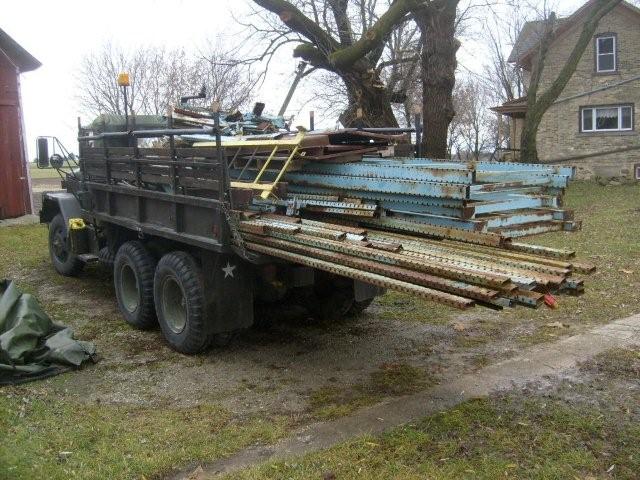

I had bought a bunch of Pallet racking system last year and stored it in the barn..all but forgotten... then a brain storm.(.haha, ya right)

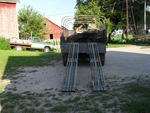

took a bunch down to shop and cut to legnth of deuce bed.. cut up some for 10" spacers.. made this design and WA-LAAA.. drove a skid steer up them.. guess they weigh in at around 80lbs each.. still easly for one MAN to handle though.. they are 12'3" long and 16" wide i have spaced the keepers that drop in between the tail gate and bed.. so that they will center for either my m151a1 or the mule as pictured, with out obstruction of the tail gate hinge.
ill post a picture with jeep next week after i replace its fuel pump...GRRRRR.
