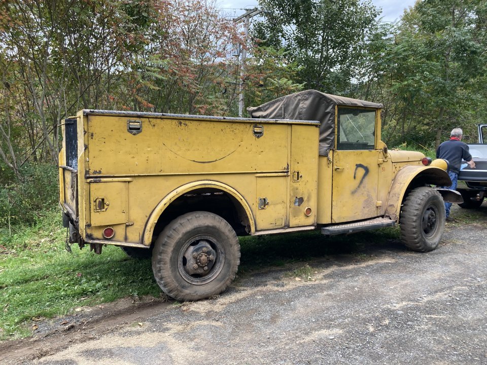

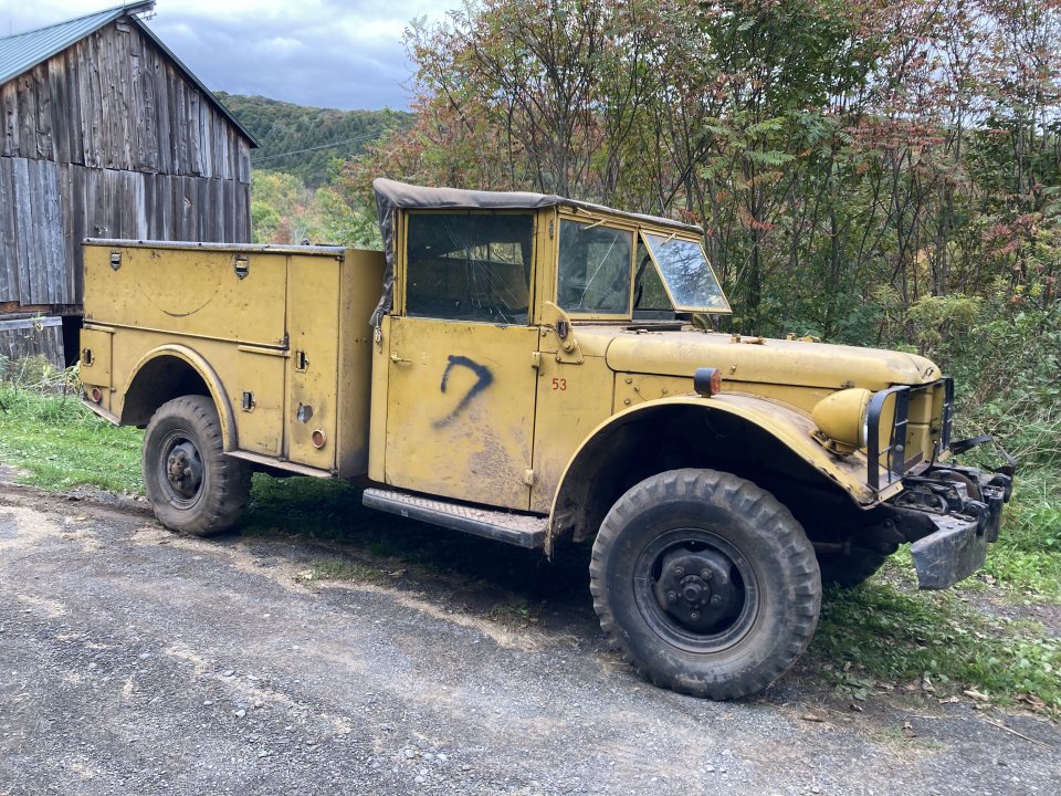

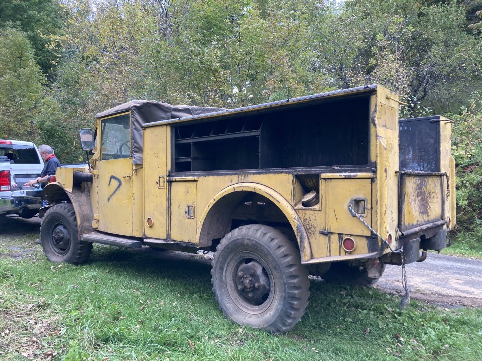

Howdy folks thought I’d drop in and sign up to your awesome website. Somehow I’ve managed to get myself a barnfind m201b1 m37 1962. Not quite sure which direction to go yet. A good cleaning first then get a game plan. A lot to think about. Thanks for allowing me aboard!! Have to thank my friend from work Mike who is helping me get her running. He’s also a member here and has a deuce.

So, first out of the gate: Welcome to the Outfit! .
Wow! That is neat for sure...
It almost looks like a mechanics service truck. Might be or not.
Congratulations on your rescue!
I don't know about you, but somehow getting the motor to crank or not seems to be first priority. Being able to hear the quiet rumble will help you stay motivated too. Maybe pop the plugs out and squirt several shots of Marvel Mystery Oil in there and let it sit. Then do that a couple more times - and see if you can turn the motor over by hand. Depends on how much stuff you got with your truck - but you might even have the manual (hand) crank handle that plugs into the crankshaft. If it turns over it might be worth playing some more.
Maybe disconnect the fuel line - guessing that it has rust in the tank - and see if you can bottle feed it with the magic of gravity.
You definitely have some work to do, but I think you got one heck of a truck!

Very nice find !!! rare MV , looks pretty complete , does it have a PTO generator welder ?? also looks like it has a fender heater . Nice find . That might also be the LINESMEN truck . Welcome to the site .

im thinking it is the linesman model. It’s really solid dispite the missing box door. I think I can make one fairly easily. All 4 corners are straight.! Going today to get the rear wheels unstuck from 40 years of sitting. Bring her home! Thx again!

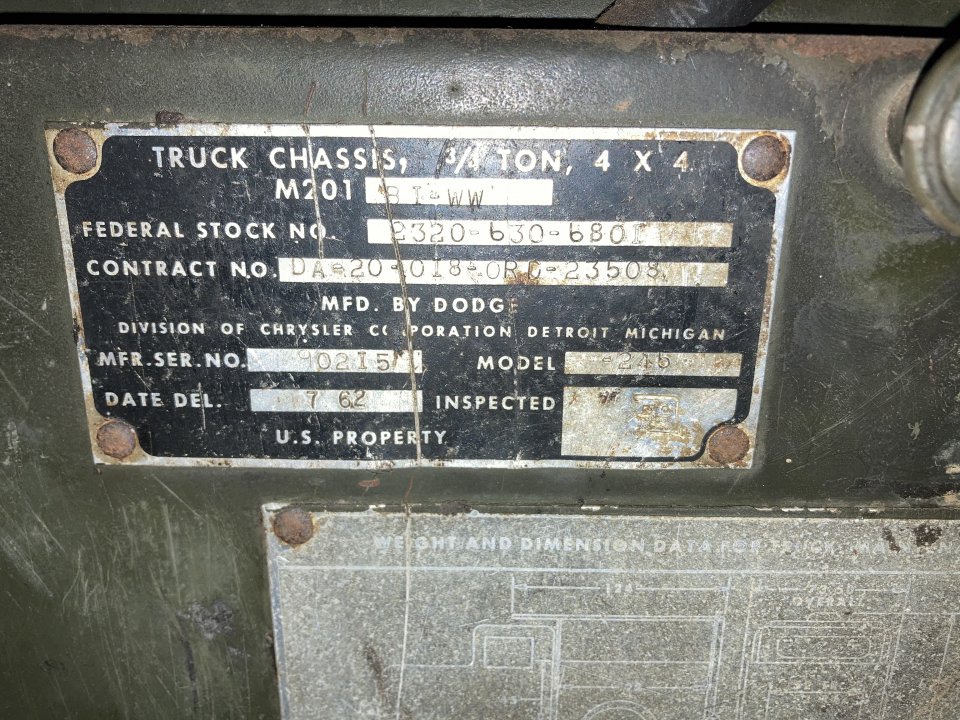

That’s a awesome piece, congratulations on a good find. I’m not well versed but I’m pretty sure those are pretty rare when new and especially now a days. Just a quick search online and if correct there were only around 500 or so built in that configuration.
Thank you! I think I did well also. I’m making the seller a nice smoker/bbq in trade . Yes just about 500 made. I’ll do my best to give this truck the love it deserves for its service to our country. Peace!
